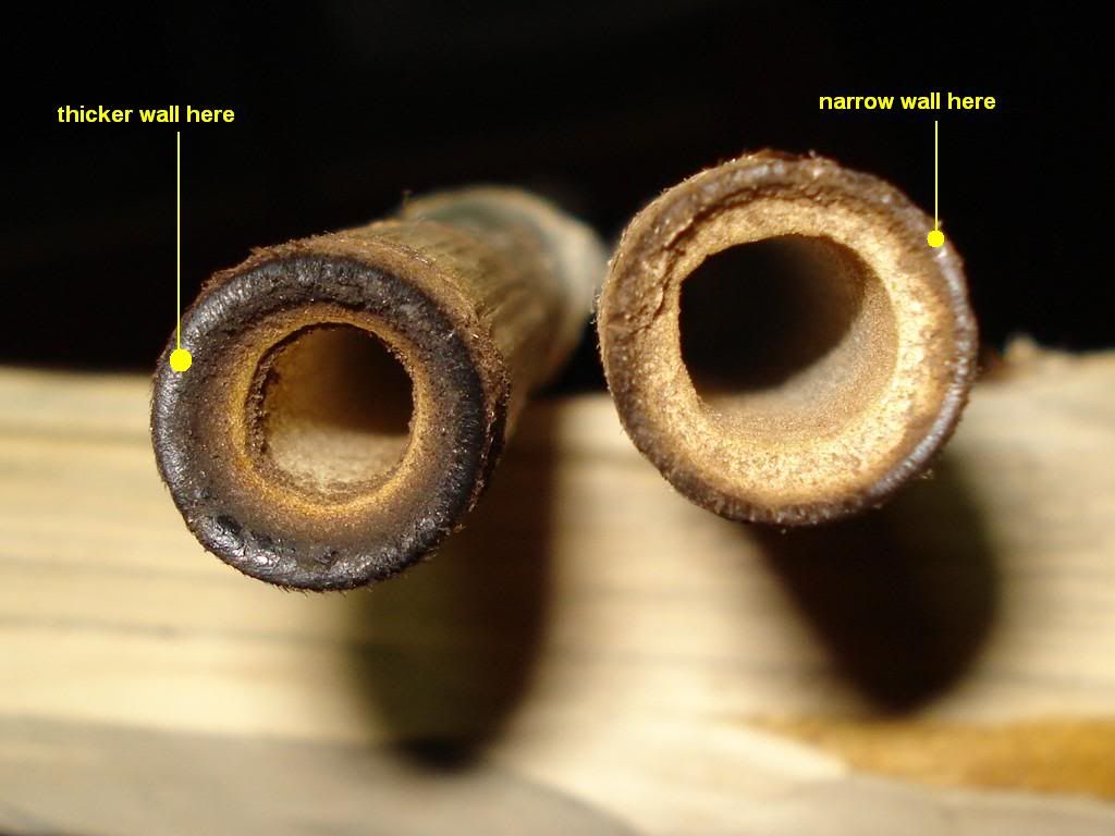

One other thing, when using Teasel, at least this late in the year, is the wall thickness.
In this picture you'll see the difference in wall thickness that I'm talking about. If the wall is too thin, you'll still get smoke but you will be hard pressed to get a coal.

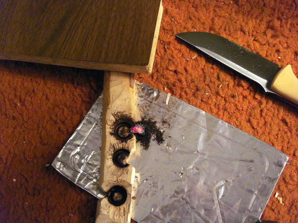

ETA in this picture, you can see what I mean about the outer edge of Teasel doing the work rather than the whole end.
Thanks Doc, I really appreciate the pictures and input. I know I have seen that in my wanderings here somewhere...I'll look for it more purposefully next outing.
Is that a Basswood hearth board?
