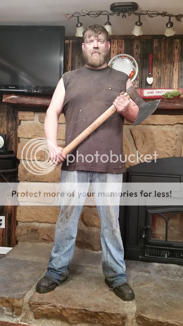

A very good friend asked if I would make him an axe similar to Rolls from the show Vikings. Double horned, etc. This is what I came up with. The body is mild steel, wrapped and welded eye, with a 5160 bit forge welded in. It is 9.5" tip to tip. Handle is 29" and it handles like a dream one handed or two. I look tired in the picture, normal job has me working 7 12's lately so I had just finished a 12 hour shift at 5:00 am, drove to the shop and spent the day forging this.

I didn't actually realize how rough I looked with coal dust and grime all over me until I saw the picture.
