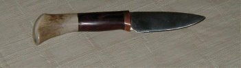

Nicely done. I enjoy forgeing to shape....usually 90/95%. My dad gave me a piece ot steel he said was the last piece he had left of his boat....3"long...3/8" round stock....Can you make a knife out of this for me??? I gave it to him for his birthday. Feels good to be able to do stuff like this.
