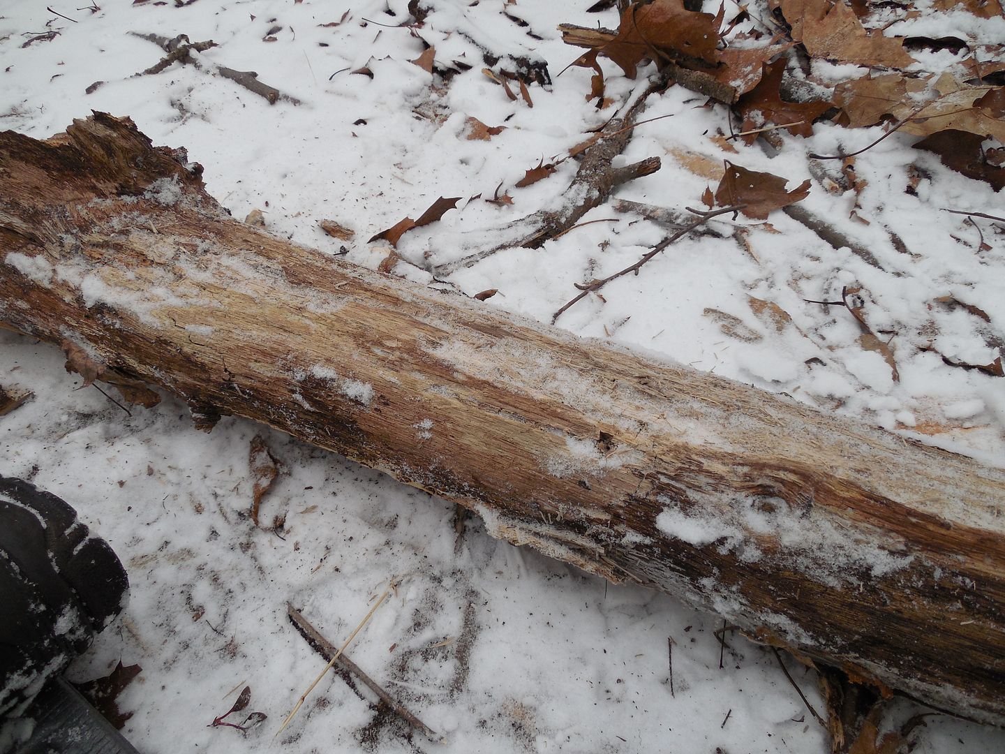

A person can hold the handle and strike the rock on the spine. The downside being the blade can bounce around some. It was mentioned that sticking the point into a log would support the blade. Not too far away was this log. Granted it wasn't a big log however location, location, location.
I tested the knife sticking in log method and it worked but as stated IMO holding the blade and striking steel on rock is easier in some situations.

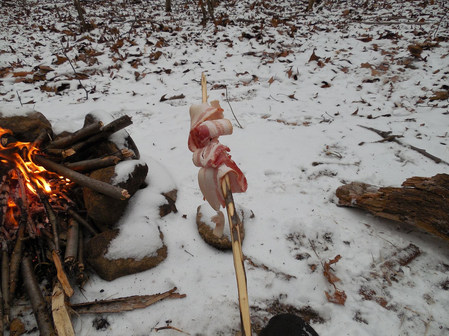

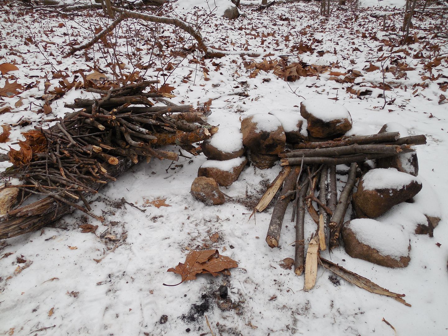

Twig fire ready to go.
Bacon!
