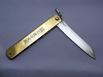

This is kind of probably not what OP had in mind but how about Japanese Higonokami which have not only hand ground blades but hand forged blades.
Blades done by an apprentice smith can be as cheap as $25. Those done by master smiths can go upwards of $200.
