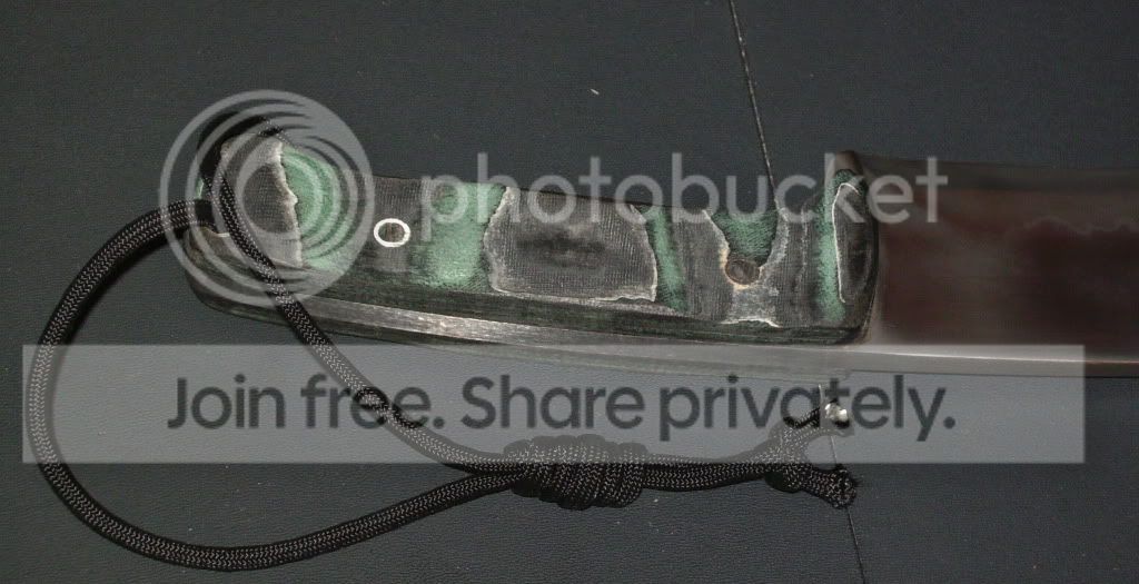

my box is 6x10 and i make blocks 4 inch tall at a time i use 8-10 yards of canvas and over a gal of resin at a time (i can still tell you how pissed i get when i have voids even after doing this for years )
http://www.harnerknives.com/wp-content/gallery/holding/dsc06218sm.jpg
