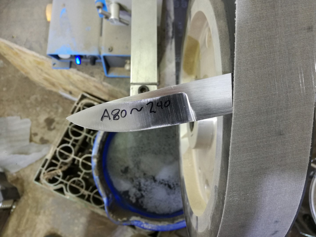

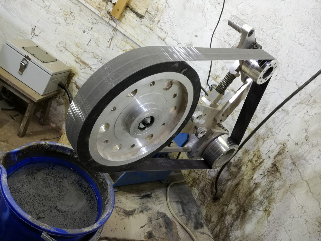

I'm practising hollow grinding and I actualy like it. (11,5"wheel, 25% speed)
I also like hand sanded blades, so I'll be needing a sanding block in the same diameter as my wheel is.
What do you guys use for hand sanding a hollow ground blade?
Can you show me a pic of your sanding block/stick?
Any othe general tips?

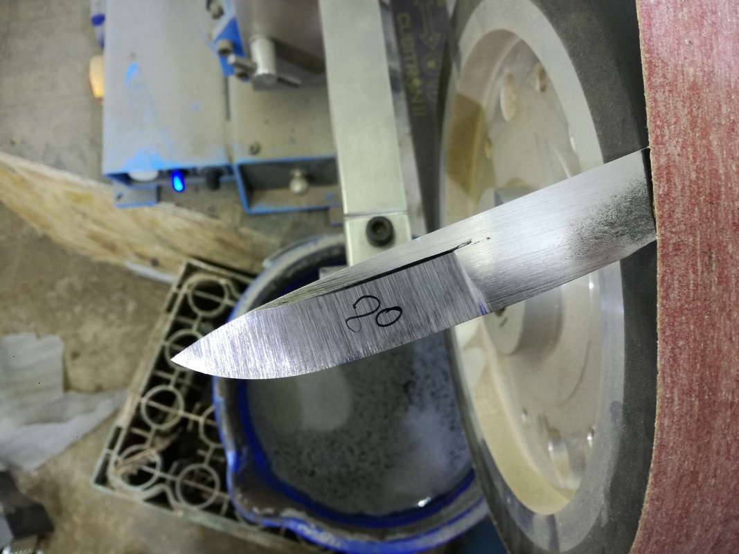

I did these on a 80 grit belt followed by a 120 grit belt:

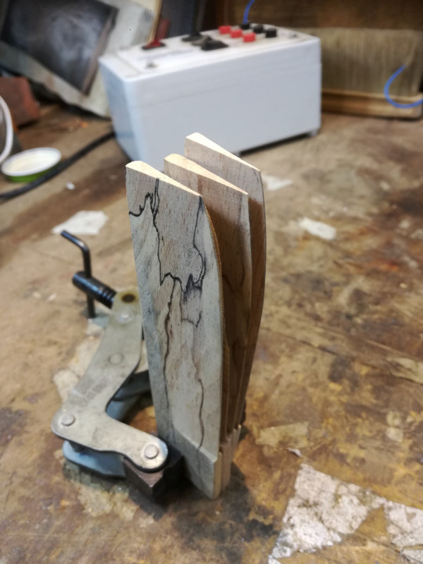

I use EDM stones to hand sand my hollow grinds when I make knives from W2 and need to bring out the hamon, I dunk them in water and they slowly form to match the hollow or you can shape them to match the hollow. Other than that you could take some thick micarta and cut and grind the radius to match. You would probably want to keep the sanding stick/block relatively narrow so you can effectively wrap paper around it, think of it like a sanding tooth brush.

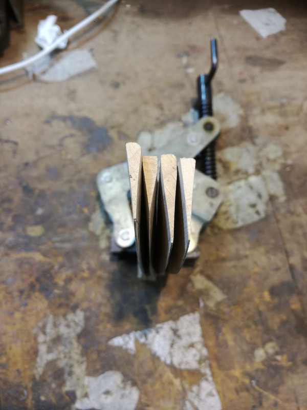

I use a piece of aluminum or micarta and trace the radius from the wheel onto it allowing for some rubber or leather glued on top.
On folders I like hand sanded blade, on fixed blade a belt finish
Kyle Daly (khdaly knives) makes radius sanding blocks to your specs on his 3D printer. He calls them a Sanding Buddy and they are absolutely awesome. I also go 2" down from whatever size wheel I'm using. For instance when I do a hollow grind on my 12" wheel I use a 10" radius block to sand and then sneak up on my grind lines. This keeps your lines looking crisp and not washed out.

I definitely need to work on the plunge line but this one is about the hollow grind. And for a first one I'm pretty happy with it.
I'll have it HT-ed, put a simple handle on it and use it in the kitchen to see how I like it.
This is what I did this afternoon.
All tips/comments welcome

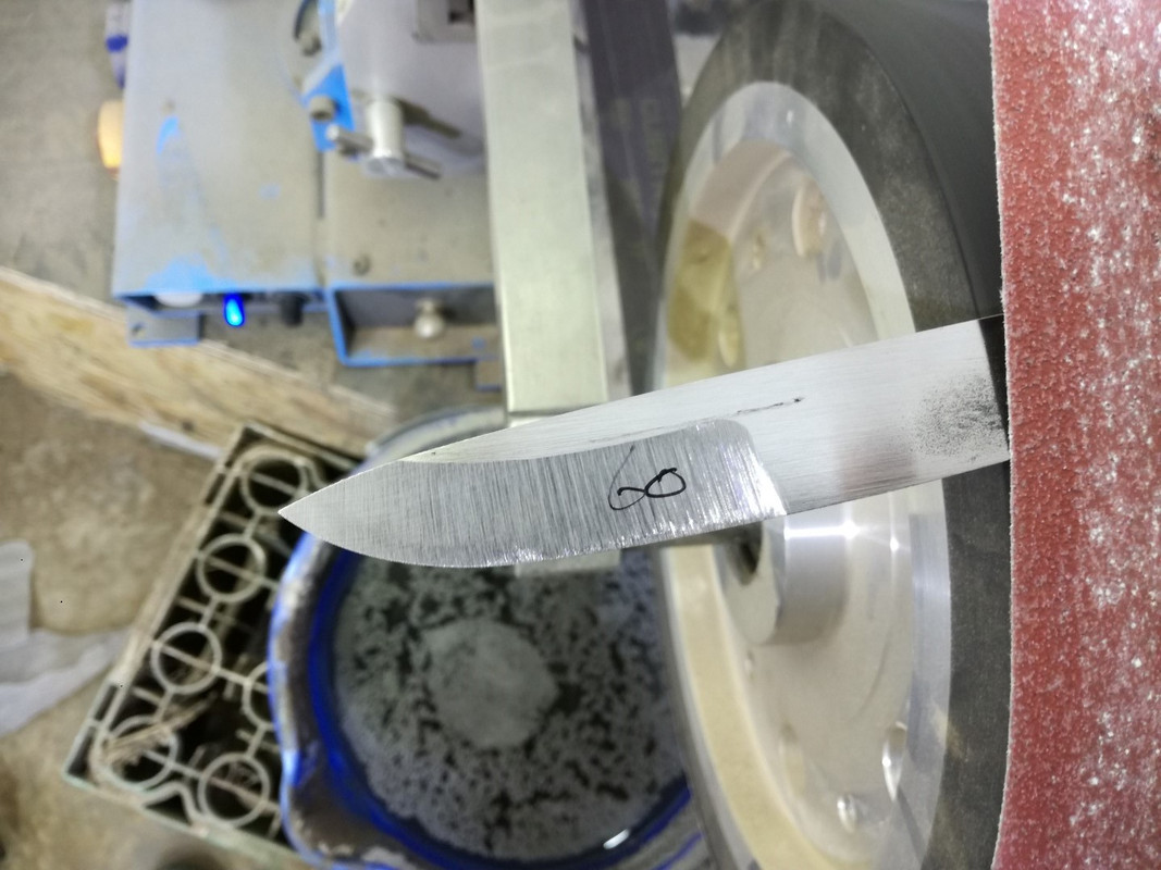

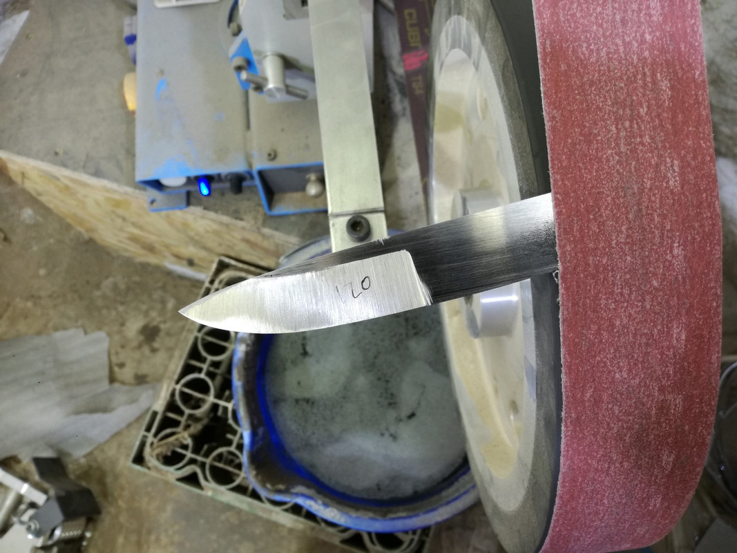

Now I put the hollow on the KITH knife and on another nakiri I am working on. Couldn't get a nice machine finish on whole blade so had to hand sand. I can get a decent 400g finish on the hollow but my lines are not fully crisp (serrated wheel might be part of this problem...). Pics of my attempts, critic, advice welcome.
After widening the hollow and trying to finish the flats with a surface condition belt I had to hand sand. Hand sanding washed the crisp lines away. I hand sanded with a hard wood block with a 1" smaller radius. I will do a micarta block next.
Went up to 400g and then hand sanded. Again lost the crisp lines but finish is uniform after hand sanding.

i found that if my half moon sanding block is the same size as my contact wheel, i cannot do alternate 45 degree angles. if my blocks radius is too small, there is hardly any contact area. i do my first grit lengthwise to the blade to get rid of the machine scratches running across the bevels from the belt. it seems to be the most efficient way. then on the second grit i go to alternating 45 degree angles to be absolutely sure i got rid of the previous scratches. i like a hard block so i do not run over the centerline of a double edge grind, or the bevel to a flat above a single grind. you can feel when your block is running on the edge of a grind. for my 4 inch wheel i use a 3.5" radius block, for the 10 inch wheel i use a 9 inch radius block. i use micarta, or sections of pvc pipe.

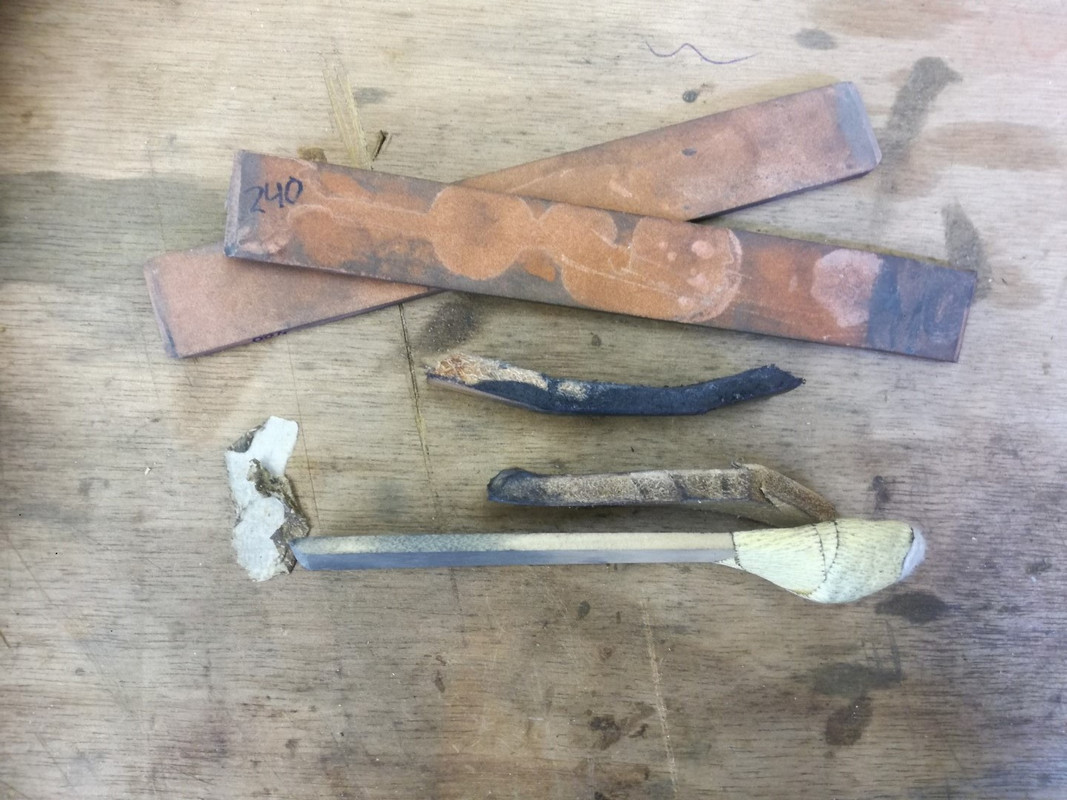

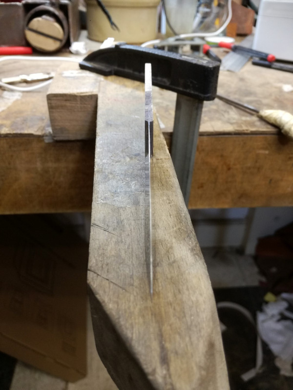

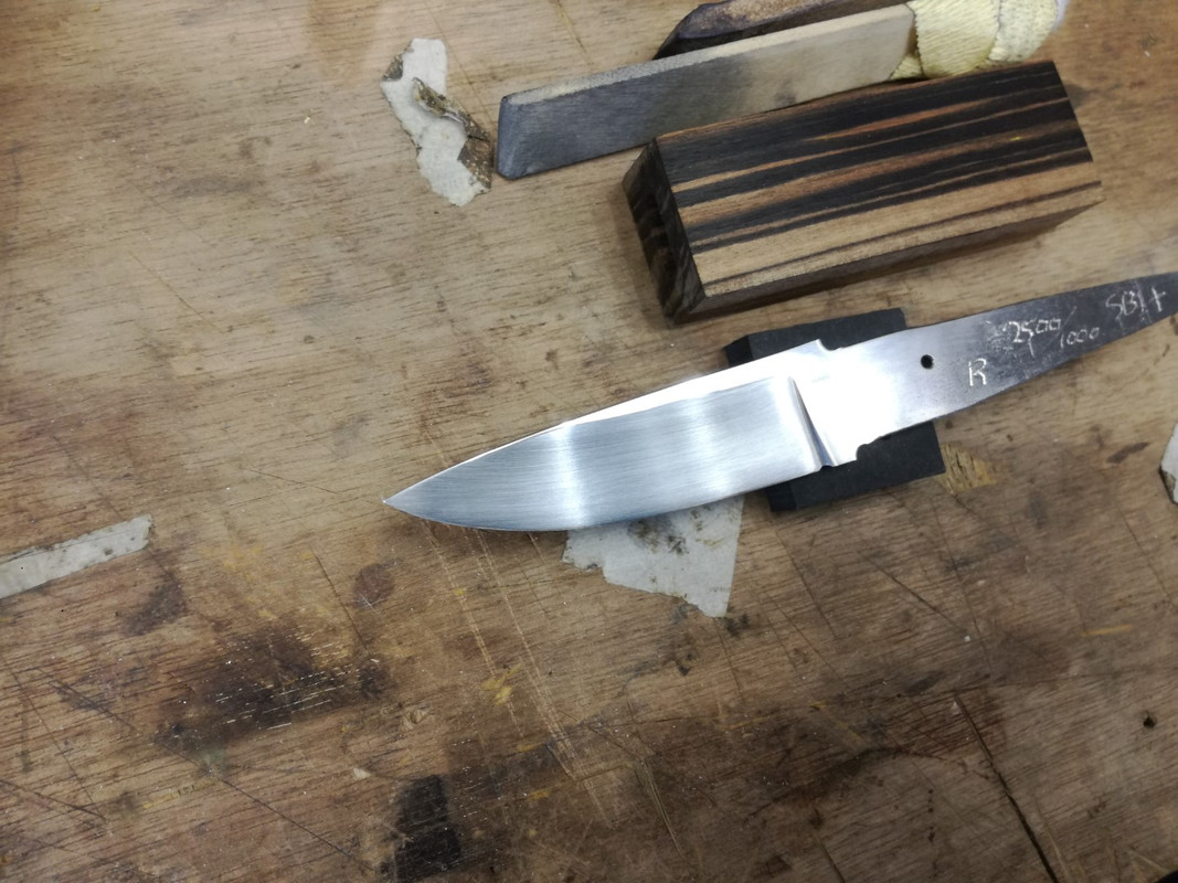

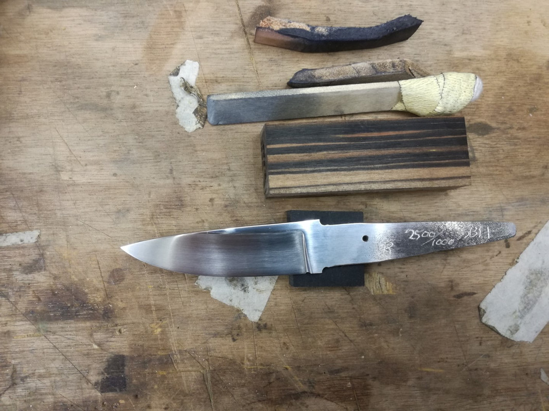

I made pics of the sanding "blocks" I ended up using.
First cheap chinese stones, then a push stick to sand spine to edge and two pieces of sole leather.
This one is ready to send out for HT, 3" blade with the bevel at 1000 grit and the rest at 2500.
Niolox+ steel and I may end up using that block of Macassar ebony as a handle.
