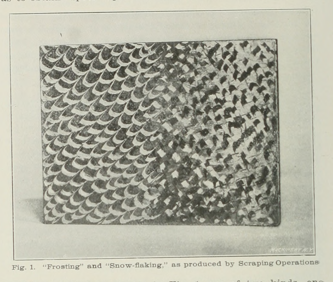

I stumbled across an old educational video, detailing a machining process called metal scraping. Using a surface plate, some Prussian Blue, and a series of tools resembling chisels, the machinist could achieve a completely flat surface. The process was also used aesthetically to create an effect called "frosting". It produces a really interesting surface patern.
I was wondering if anyone knew of such a finish being used for a knife.

No, scraping is a precision finishing method. It is used to create flatness in the near millionths of an inch range. Grinding machines can only do so well, and this is what is used post-grinding to dial in near perfect flatness. It's used for precision mating fits and alignment. It's a very involved and labor intensive process, and isn't simple, nor easy. At precision of this level, even the touch of your hand can cause enough thermal expansion to ruin a fit.
Frosting is different - it's used on sliding surfaces after precision scraping to create tiny troughs that hold lubricant, so that the fits on these precision surfaces don't glue themselves together or run dry.
This is a large and involved subject for those who aren't familiar with machining and precision fits - if you want to know more, Google will help you.
Oh, and yes you could use it as a decorative finish on a knife blade easily enough. Modern scrapers are tipped with tungsten carbide, which can fairly easily cut hardened steel. Making it look nice would take some practice though - I'd suggest starting on some scrap.
