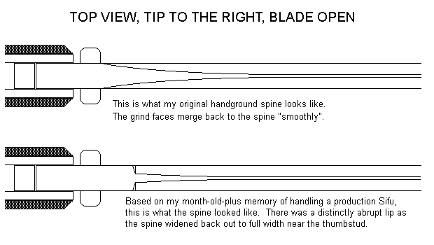

Maybe I can help. My hand-ground Sifu had one very noticable difference from a production version I handled at a recent gun show. I had mine with me at the time, and was carefully comparing.
On the spine, both have a false edge. On both, the false edge ends near where the thumbstud is.
On my handground serial number one, the false edge blends back into the spine "gradually" and smoothly near the thumbstud. On the machine-ground, that end of the false edge came "abruptly", with a bit of a "lip".
Hope this helps...

Anyways I examined the spine at the thumbstud.. it does seem a bit smooth and rounded off do you mean that the production is deal FLAT at the top of the spine?

This needs a picture:
Hope this helps.

Can someone with a machine-ground piece confirm my impression of the spine layout?

I have a Black-T BF logo Sifu (production). It has the "lip" at the back of the false edge as Jim illustrated.

Jim nailed it... the handgrounds have visibily different top grinds, with the machine ground ones having a much shorter, abrupt ending with visible vertical grind marks.
The hand ground ones have smoothly tapering grinds on the top, much more appealing, IMHO.

Hey Jim really cool drawing. Care to share the wealth with me about how you did that drawing. I am interested in buying a somewhat simple drawing program for my knifemaking hobbie. I don't know alot about these kinds of programs.
Is that a CAD program you are using or is it simply the paint program supplied with windows.
I don't have alot of artistic experience so I am looking for a good drawing program to help.

That's plain ol' Win98 Paint.
The Win98 version is unique in that it can write out .GIFs and .JPEGs in addition to the native Paint .BMP format. If you've got Paint for '95 or NT4.0 you can only write out .BMPs. I'd be willing to bet the Win98 Paint will run under NT4 and it's probably included in Win2000.
The key to understanding Paint is, once you "encircle" something (using the square-with-dotted-lines tool) you can hold down "CTRL", click and move the selected bit and you'll COPY whatever you selected. Then, while the selection is off to one side, use the "flip vertical/horizontal" command and produce a mirror image version. In other words, on the top pic of the blade spine, I made a rectangle, then somewhere below made a broad flat circle. I then cut away 3/4ths of the circle, leaving only the bottom-left corner. That was then dragged into the rectangle to for the upper half of the spine curve. I then copied that upper half, flipped it vertical and lined it up below it's upper mate.
Ya just gotta play. Remember, select something, hit CTRL and drag to copy it, flip it and move it back into position.
The lower pic was the easiest - grab and copy the top pic, erase out the gradual fade on the spine, draw in two little lines, copy that, flip it, move it to the other side, presto.
