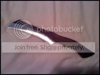

I have a blade in progress that still needs to be heat treated. Until I get it heat treated at a friends shop, I've been considering handle designs and I'm stumped. I have decided on Snakewood for the handle, but I feel that it needs something more. It will be a mirror polished blade with a unique etch along the spine. I'm trying to decide what material might look good as a transition between the blade and the Snakewood. I've considered Stainless Steel, Nickel Silver, Brass, Copper, multiple colors of G-10 and Onyx/Gold Gemstone Composites, but I don't know which to choose, if I should use something different entirely or if I should use just the Snakewood. Any suggestions would be greatly appreciated. Thanks in advance!

Your link doesn't work. It's an abbreviated link (it has "..." in it). Picture is not viewable.
Link still not working.
On a highly figured handle without a guard, there is no need for whistles and bells. A bolster is fine if it compliments the blade as well as the handle. A simple 1/8" thick mokume bolster/guard and butt cap work well with snakewood. Bronze works ,too. I would think stainless may be too harsh a contrast, but without a photo, I am just guessing.
Hmm, interesting blade shape. For something like that I would lean towards the industrial side of things. Maybe bluedor patina'd mild steel bolster with a dark red thin spacer. Wrought Iron would look good as well as bronze I think. A dark bolster I think looks better on a mirror blade. As always there are exceptions.

First thing that comes to my mind when I look at your blade is: A blackwood handle!
Wow! That wasn't what I was expecting at all! Pretty cool.
The handle shape reminds me of a Colt Peace Maker pistol handle and a "white" metal engraved and antiqued bolster.
Or, a black micarta bolster with a thin white or ivory spacer between bolster and handle.
