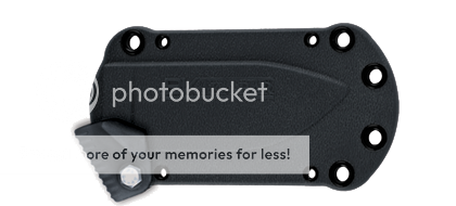

What kind of locking mechanism are on the new ones? Is it an active retention or just a better plastic protrusion to retain the blade?
From the KABAR website:
Sheath's supposedly a bit softer and the thumb lock mechanism thingy secures the blade in the sheath until it's pivoted away.
Thanks for posting that! Never seen that before, looks a bit odd but seems like it'll function great

That lock system works good and so far I have had no ooops and I fully trust it now 100%.! It stays there till you need it.!
