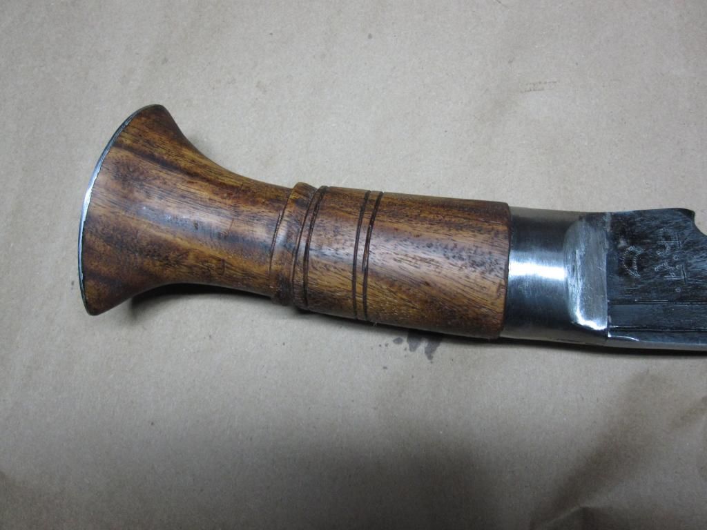

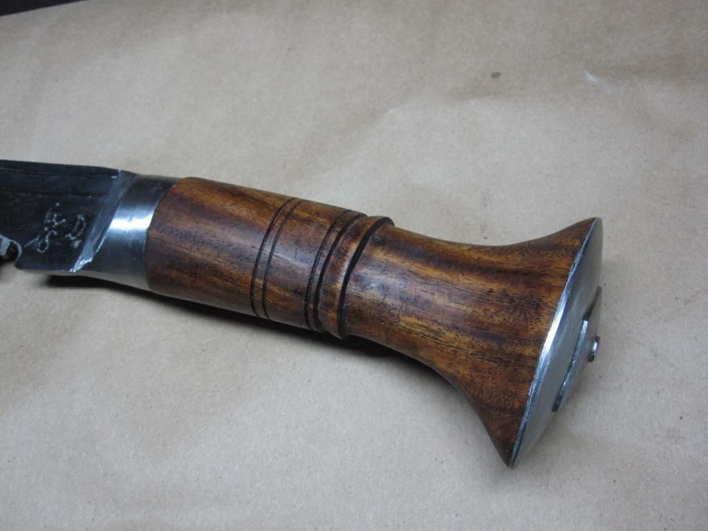

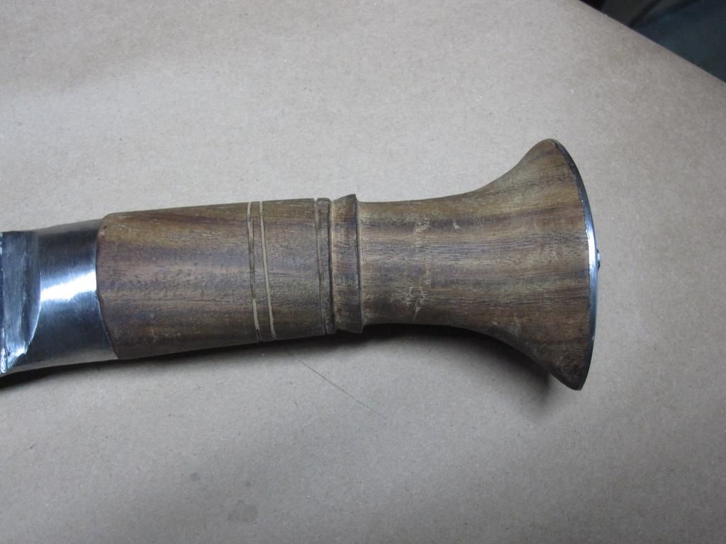

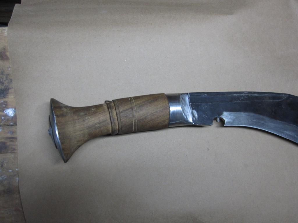

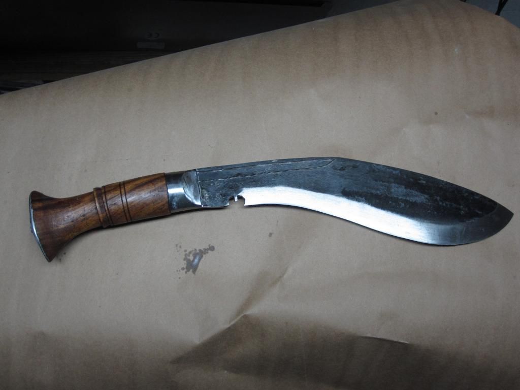

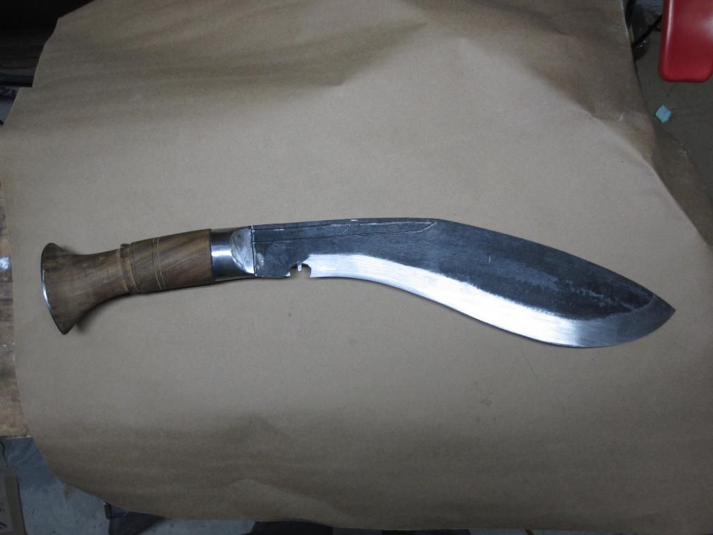

My new Villager Bash Katne is a real monster, as most of your already know. I wanted to show a couple before and after photos on the sanding & oiling treatment that I put on all my villager finish knives. They tend to start out a bit rough but still totally usable. I like to finish them out to 600 or 800 grit with sandpaper and then seal them up real good with as many coats of Tung oil as I can stand to do.
Here is the "before" of the Bash Katne by Keshar Lal:

And after sanding up to 600 grit, with 2 coats of 50/50 Tung/mineral spirits, 2 coats 75/25, and one coat pure Tung. It will need to soak in for a couple days before I put the next coat of pure Tung on. I will put a new coat every day for a week or so.

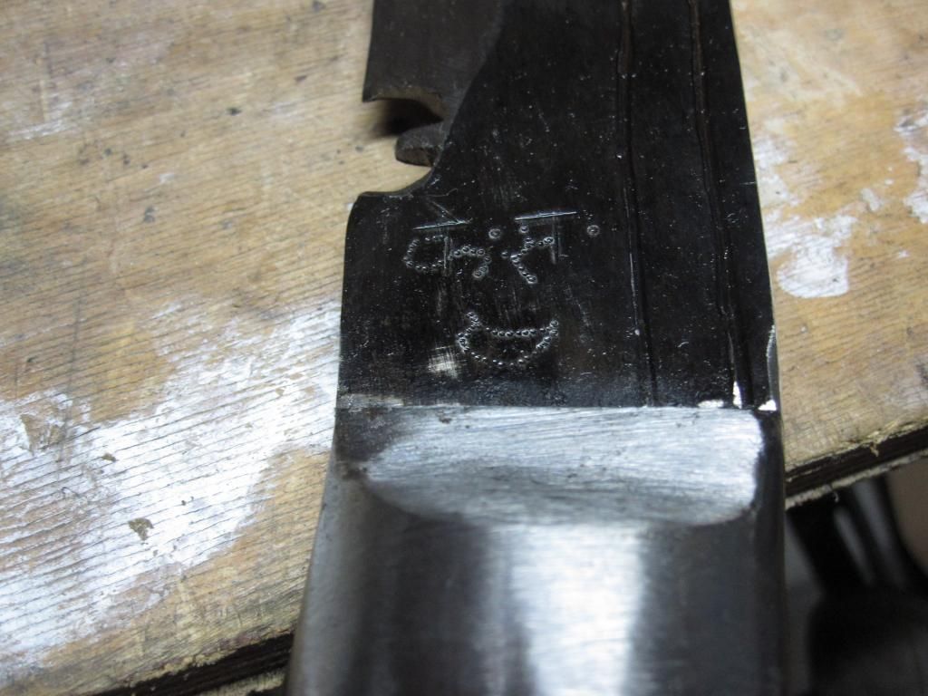

Very nice job Philll. Interesting makers mark. Looks like punch marks? Thats some nice wood!
Good eye. The mark is interesting indeed. Looks like he used a punch and a straight line. The other side is done the same way. Seems like KL is always looking for different ways to do his mark.

Sorry pk I didn't take any other photos of the process. All I really did was very lightly file out some bigger chips towards the back of the handle with a round file, then did a sandpaper progression of 320-400-600 because that's what I had on hand. Wiped the handle with a clean rag between grits. Use the sandpaper like it's free. After that mix up some 50/50 tung oil/ mineral spirits, dip a rag in it and go to town on the handle. Let it soak in for a while then lightly buff by hand with a different clean rag. Then pour some more tung into the mixture to make it 75/25 and repeat. Then go to the pure tung oil. The pure tung takes way longer to soak in so you will have to be patient between coats.
Hope that helps!

nice grain contrast that came out, looks like walnut almost.
I agree the wood looks a bit like walnut.
