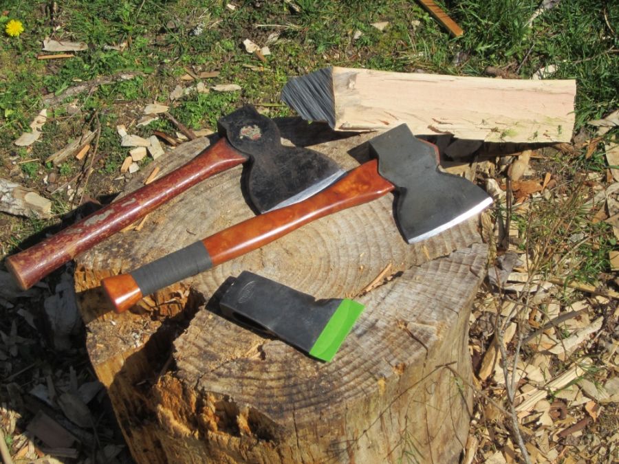

Well, I suppose I could contribute to the original post. I like my hafts smooth, however, I must admit that I haven't tried doing any hafts like Ernest's and I believe G-pig leaves his a bit more rustic too. I should try that soon and see how I like it. I could always refine it if I don't like the feel.
Anyway, on my single bit I replaced the haft with a 36" store bought hickory haft that needed extensive thinning. Once I got it to where I liked it (thinned, smoothed and sanded) I put multiple coats of BLO on it and found that the haft was a bit slippery for my liking. I had noticed Pegs championing the tung oil on top of BLO method for a grippier finish so I tried that with some tung oil I happened to have kicking around. I put 2 or 3 coats of tung oil on the haft (equal parts tung oil and thinner plus a dash of Jap hardener) and was pleased with the results. It left a matte type finish that was quite a bit grippier and feels real good in my hands.
Another route you can go if your haft is already as thin as you want it but would like to add some grip is friction tape. I made the grip on one of my hewing hatchet hafts a little too thin for my liking so I built up the diameter of the grip with friction tape. It feels much better now and has quite a bit of grip to it. It also has a couple coats of tung oil on top of BLO.
