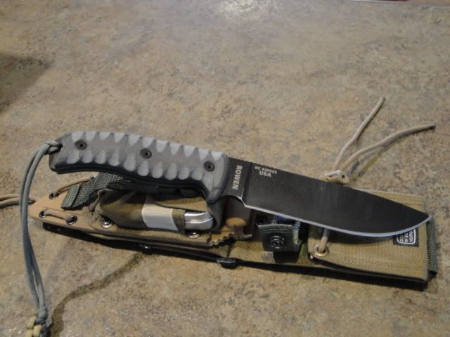

i did some dremel work on one of my 6's i didnt leave any sharp edges and its very grippy and comfortable to work with.
eventually i wore most of the finish off and just stripped the rest and dyed the scales and made a leather sheath while i was at it.

Those grips look really good. So if i dyed it before hand then dremeled it like you, The cut outs would be much lighter?
yes it would leave the original color where you dremel away material. one thing to keep in mind if you dye them be careful of the liner if you put the scales in boiling water which is one way recomended on the dye package they will swell up and not fit right anymore. i used usmc black leather dye for mine and just painted the dye on and let dry, then sprayed a coat of sealant on it.
