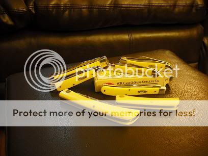

i just felt like we needed a picture!!!
thanks
sam
