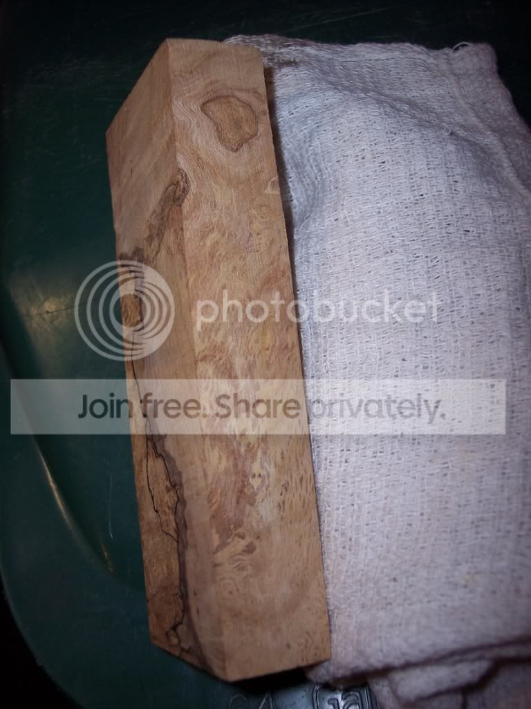

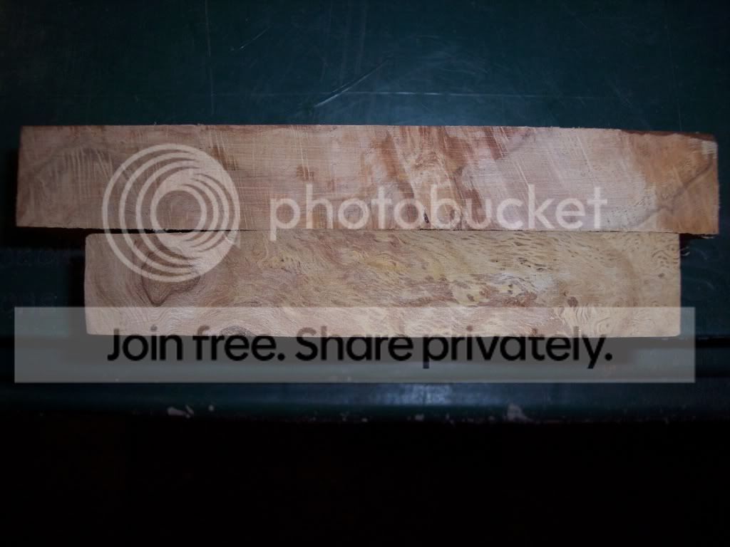

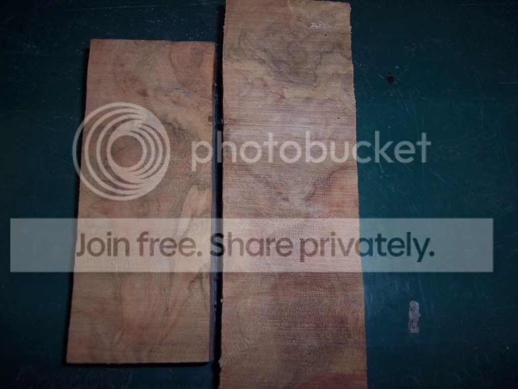

Larry, don't think that's oak at all. No distinct oak med rays and the grain is maple like..not oakish :) Med rays showing in upper right corner of far right piece seems to be maple rays...not oak. Maybe post another photo showing clear grain?
Larry,
I think you could very well be right on that, but I'm not sure. I asked specifically on these burls when I bought them and was told it was oak. I thought it looked like maple too, but he sells a lot of spalted maple burl as well, but these he said were oak. I have some other oak burl blocks too, they were cut from the same exact piece, but without any spalting. :o Heres a couple other pics. I tried to get some shots of the grain pattern. The side shots show one of the spalted burl blocks from the very first original pic.
Guess that means I'm stuck with these ugly old blocks.....:p Either way I appreciate your input......
Those new photos have oak rays and cells for sure. When you take the new baby out for a stroll you do not want to see folks whispering amongst themselves when glancing your way :)
HA HA HA....Well thanks for confirming its oak, its hard to tell sometimes. Better mark those now. ;)
-Larry
