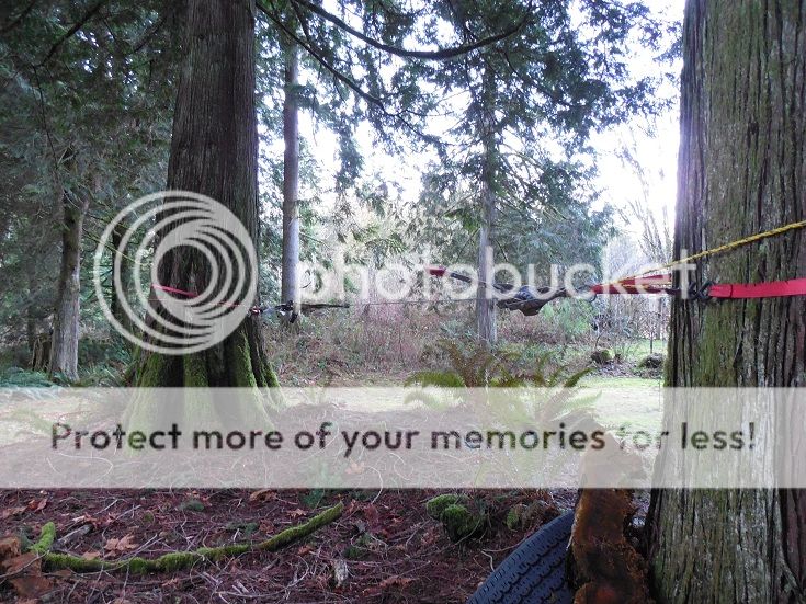

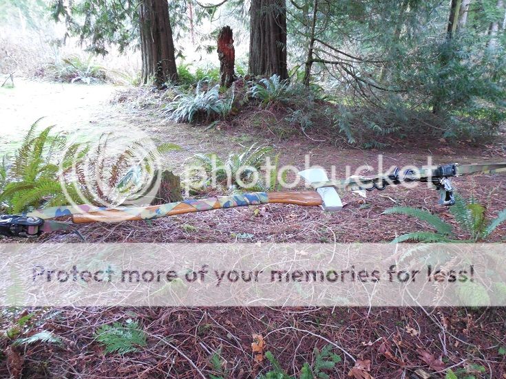

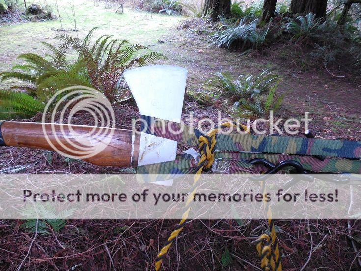

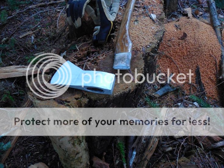

I wanted to take the handle off my recently acquired junk store Wetterling without damaging it. It has a slight warp and the bit was poorly hung but the grain is excellent and I plan to straighten it and rehang the bit after I clean it up. I let it dry out for two days behind my woodstove to shrink it a bit and I got a bit of wiggle from that. Then I got five ratchet tie down straps and a come-along and strung the thing up between two trees. I used a rubber mallet to encourage it. I believe it's a two ton come-along and I was near the threshold for putting any more tension on it. For the record there were also safety glasses, heavy gloves, and a constant awareness of possible trajectories should it pop loose. The handle came off intact with the wedge still in place and no damage to it or the bit.

I've worked with longer, heavier cables under much higher tensions. I wasn't expecting much to happen and to be honest the end was pretty anticlimactic. The handle and head each moved about two feet towards their respective tree before reaching the ground. If there had been more cable out or any elasticity in the rig I'd have pounded some posts in alongside the cable to block any whiplash.

Hmmmmm. Maybe I should clarify; I didn't crank on the come-along until it popped (which would have involved standing in the worst case trajectory of the bit). I put it under tension and then tapped at it with the rubber mallet (which also involved standing in the place that everything would be moving away from) and the head slowly wiggled it's way off the handle.

On the off chance that anyone else tries this; the reason why I wasn't too worried was that 1) both my anchor points were static and 2) the total amount of cable + cordage was minimal (< 10ft) and non-elastic. If you have a lot of cable out, say 20+ feet, and the tension is high enough, then the cable will stretch (elastic movement) and thus rebound if suddenly released resulting in a whiplash. Likewise if your anchor points have movement, such as one vehicle trying to winch out a second vehicle, they will both move upon sudden release, also resulting in a whiplash. Because this setup was essentially static, I was pretty confident that the head would either a) not let go or b) let go and fall to the ground (which it did)
To think of it another way, when you use a spring clamp (elastic) and the parts you're clamping shrink (glue spreads out or whatever) the clamp follows and shrinks it's grip with it. If you use a screw clamp (static) and the part shrinks the clamp doesn't move and it's no longer exerting any pressure. Once the axe head let go the haft there wasn't any tension left to make it go anywhere.
