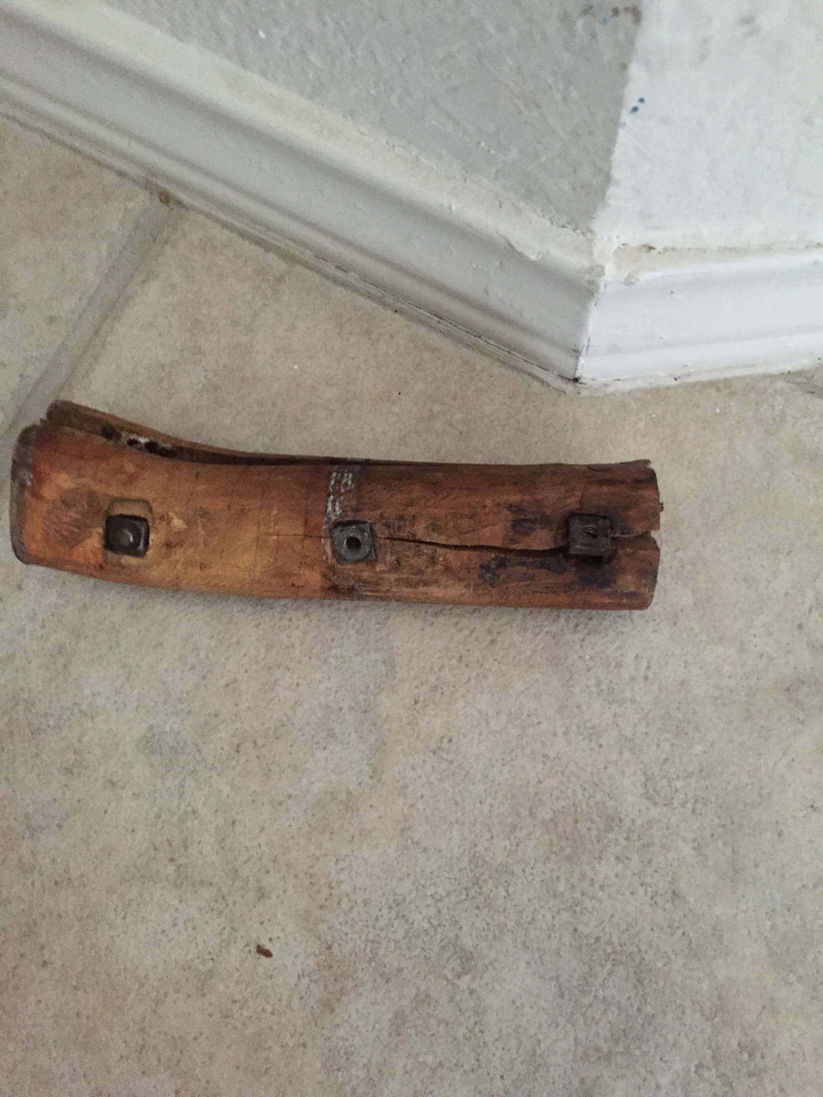

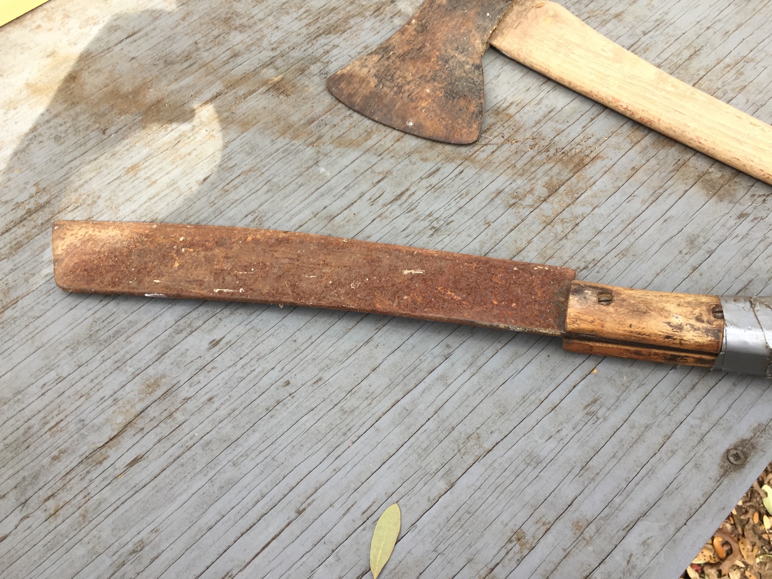

I'm working on an old machete of my grandfathers. I need to replace the broken handle on a parang but I need scales longer than 5. Where can I get them?

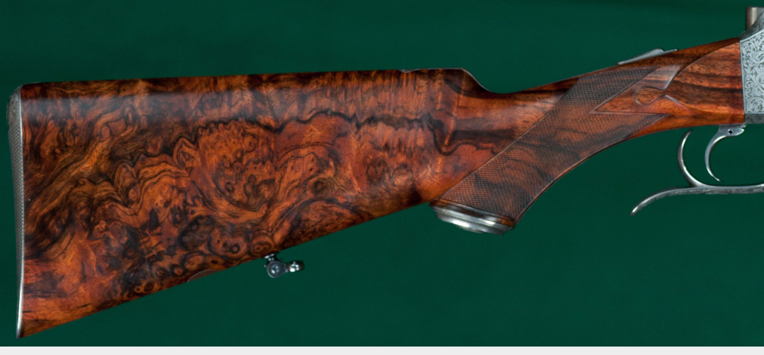

How nice do you want it and how much are you willing to spend? You can get a nice 12 inch or so piece of turkish (circassian) walnut and have someone cut it in half. Make sure the piece is as thick as you will need once cut. They use turkish walnut a lot for high end gun stocks so they're cut longer and they finish beautifully, especially on longer pieces where the grain and figure can really be shown.

But wood looks so much better and is very durable in its own right. If I wanted a tool to use today, I'd probably use micarta or something similar. If I was reworking a tool my grandfather used, I'd probably make it pretty and hang it from a wall.
That axe would look killer with some really nicely dyed curly maple. Having handles on the machete that matched would look killer mounted on something.
On a scale of 1 to 10, I give myself a four or five. I am concerned about putting the pins in the handle

Thought of this but I couldn't reply earlier. Corby bolts are an easy way to affix your scales along with some 24 hr epoxy. A drill press works well with a regular bit for the through hole and a brad bit for the counter sink. Let us see how things turn out.
Hardware store (lowes) under $4. Hardwood section 1/2 in thick, 1 & 1/2 in wide, 3 foot long. Handle in pic is 6 in long on the knife I cut out of a cold steel heavy machete.
