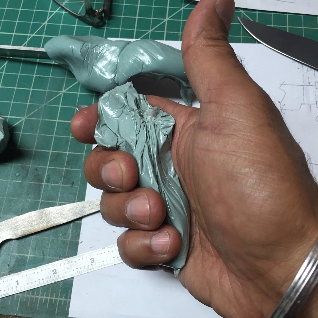

I'm also doing some work with bondo filler to learn the shape of the hand better.

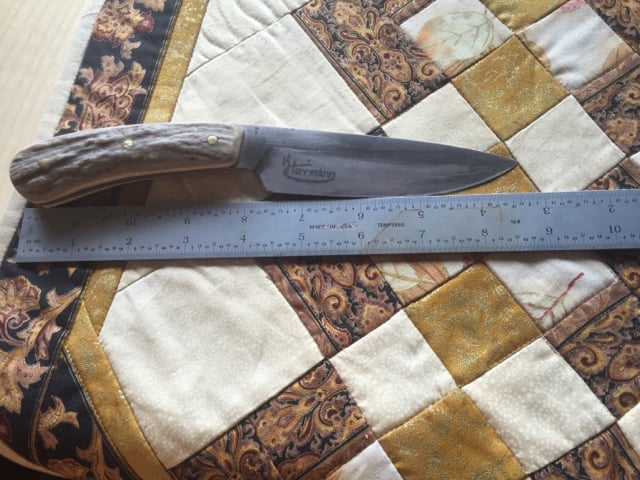

Thanks guys, this gives me some things to think about. As for pictures, I tried to put some up right after my last comment, but the internet went out just as I was loading the last photo. Bush Alaska internet, hate it, but at least we have it.
The original knife, feels great to me, but almost everyone else says that it's too small in the handle.

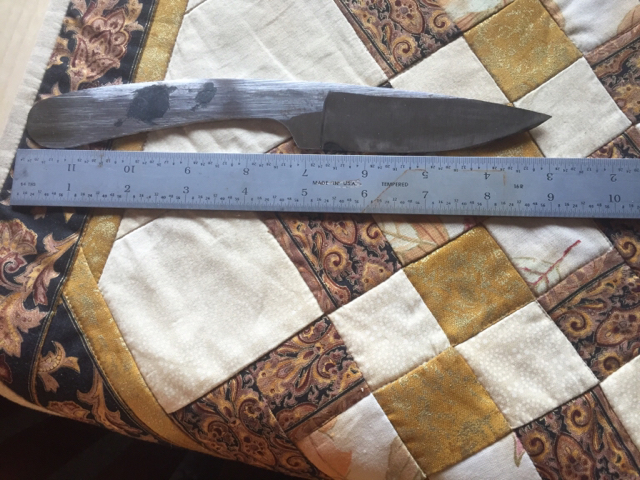

New blade with slightly stretched handle and shortened blade (per friend's request).
