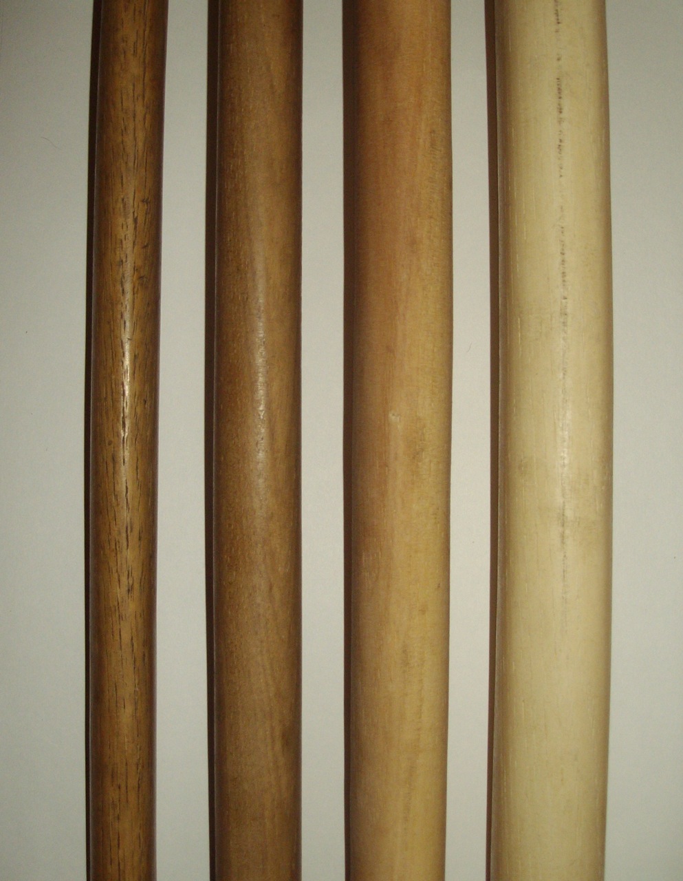

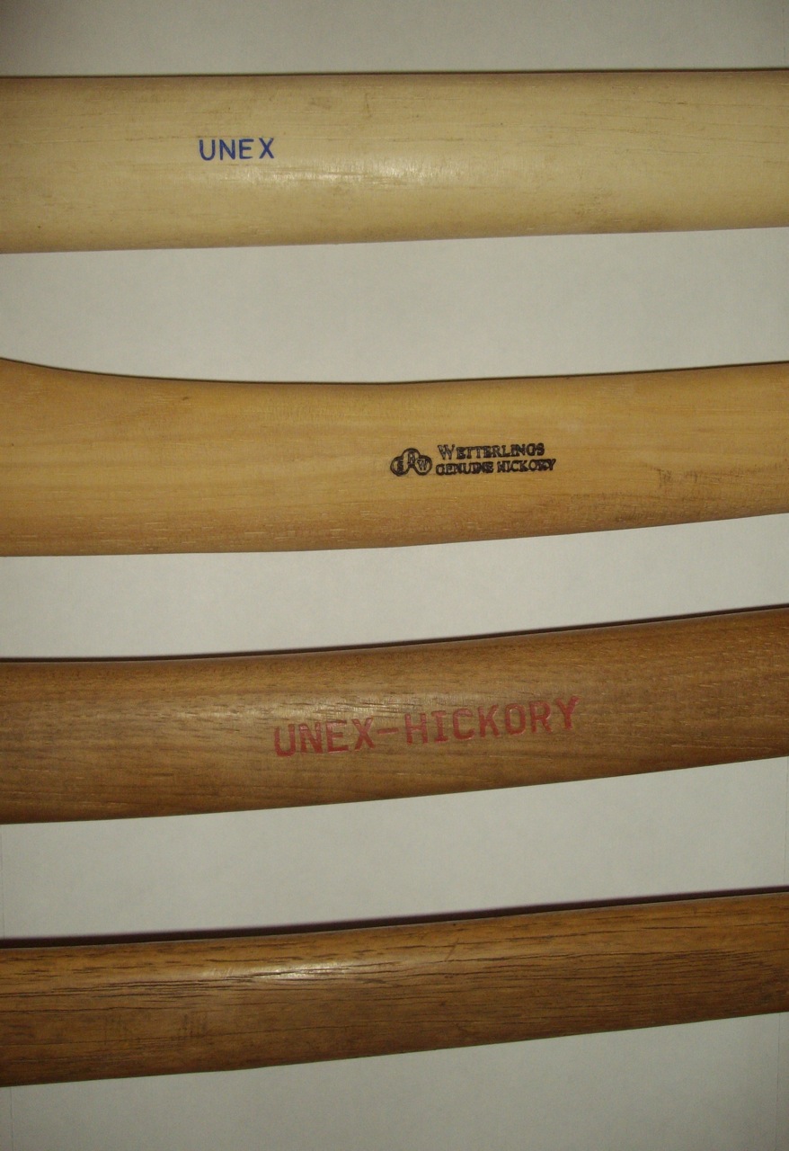

A thickness of 11/16" to 3/4" translates to 17.5 - 19 mm which can be compared to the handles pictured below from Peter Vido's post titled "The Devolution of Axe Handles" which also appears at his blog Axe Connected:
1. (1975) – 18 x 32mm, 31 inch long, head 3 ½ lb (my very first ax)
2. (1995) – 23 x 37mm, 27 inch long, head 2 ¾ lb
3. (2010) – 26 x 39mm, 26 inch long, head 2 lb
4. (2011) – 29 x 40mm, 27 inch long, head 2 ½ lb

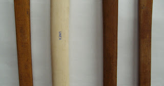

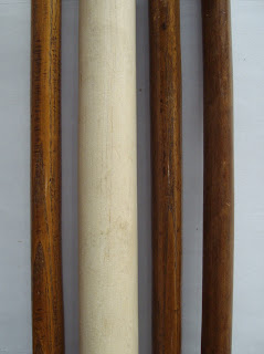

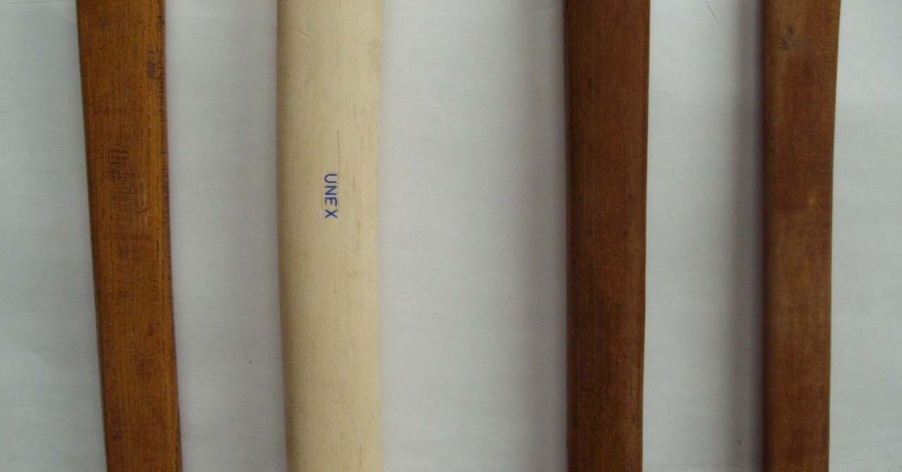

In the photo below you see three locally made handles with the 2011 “white elephant” in-between. While measuring these three (for the purpose of this piece) I was surprised that their cross sections were exactly the same – 16 x 33mm!
The respective lengths and weights of these axes are (from left to right):
32” (sugar maple) with single bit 3 ¼ lb head
27" (hickory) with single bit 2 ½ lb head
29” (ash) with double bit 2 ½ lb head
29” (ash) with single bit 2 ¼ lb head
https://www.bladeforums.com/threads/introduction-and-the-devolution-of-ax-handles.820720/
