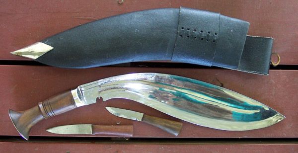

I just got my hands on a 18 inch Fox Folly(Woohoo!) and had a question about traditional Khukuri handles, reworking them.
The blade on my Fox Folly is perfection but the handle is a bit big and fat for my small hands(for a westerner) so I thought about having some work done on it to slim it down.
Anyone know anyone who works on or can work on slimming down a handle or even re handling a traditional Khukuri?
I wouldn't want to mess with it myself but my dad's a carpenter by trade so I thought I might ask him to just sand it down until it fits my hands.
If that doesn't sound like a good idea I would like a professional to handle it(see what I did there?) slimming it down for my small hands or even re handling the khuk with some custom wood.

It's not magic to slim the handle down. I'd just go at it with a file until you get close to what you want for size, then go to sand paper of progressively finer grits until she's smooth as a babies back side.
I just work it so you take every thing down together, the rings, grooves etc, I just keep everything the same just shrunk.
I'd be happy to do it for you, or I was until you inserted that professional word.
Take that out and we can talk.
I'm uneasy on a full rehandle on the traditional handle although I'm working on one now as a learning experience. I'm gaining a lot of respect for the kami's. I bet they make the whole knife in the time it takes me to make a new handle.
But I have no fear of reducing the diameter/ slimming it down.
My opinion: It's really hard to get the shape and proportions right on a rehandle. Suppose you or someone you trust made a new handle. You'd still have to do a lot of shaping/filing/sanding to get the size right for your hand. Right now you have a perfectly good handle that just needs to be filed/sanded down a bit, which is a lot easier than starting from scratch.
If you really want the learning experience, make the new handle and when it's finished then decide whether you want to remove and replace the existing handle. Maybe the best approach would be to buy the cheapest khukuri you can find and practice your rehandling on that one.

I would be honored to have you work on my Fox Folly Bawanna, you may not consider yourself a professional but I've seen your work and pics of your workshop and have always been left amazed at your craftsmanship.
I think it's important to keep the traditional handle shape like you said and just slim everything down together.
If you think it's possible I was thinking to slim the handle down as much as possible without compromising it's structural integrity and try and match the handle in the picture you find on H.I. website showcasing the Fox Folly.
Hope it's okay to borrow this pic from H.I.'s main website, just wanted to show what I was looking for slimmer handle on my own FF.

I used to think the same about them large handles but when I got my 20" AK i realized that the larger girth handles index so much better and you actually dont have to hold them near as tight (eg.Kraton etc.) to get the job done. Its a leverage thing as far as the blade twisting on you when your chopping. Your chopping with a bent knife and trying to keep it straight with a small diameter or rubberized hi tech or whatever handle and it just dont work. Get used to the ergonomics first then reduce the girth to fit. Using two hands is just so detrimental that it renders all design elements useless. Take advantage of the ring and properly use the drop of the handle like it was meant to be. Id recommend doing some research on the proper ergonomics of its use before modifying it. Once you take off the girth you cant really put it back. It aint a western blade and shouldn't be treated so. There is no comparison to western Khukris and i wouldnt even call them Khukris. You might notice HI may lengthen their handles to accommodate westerners big wide hands but they dont shrink the girth.
