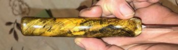

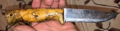

I started knife making like you. Bought some blades and put scales on them. I was too cheap to buy a Helle Tamagami for $230cdn but noticed I could buy a Temagami blank for $75 cdn. I figured I was good enough at wood work that I could make a handle. Off I went. I did a few of them and learned to shape the handles and then started making blades. Now I have built a grinder and the only thing I don't do myself is heat treating.
I can't see really well on your picture, but it looks to me like you could round the edges more on your knife. Look at examples of handles. I tend to go for a "oval" shape as you look at them from the end and bit of a pop bottle shape as you look along the length. Yours looks a bit flat to me.
The Temagami I did 5ish years ago is an off centered oval and is pretty banged up now, but it feels good in my hand. It has been my every day carry at work forever. I make much better handles now, but it was my first one and I really like it. I spend a lot of time feeling the handle in my hand and seeing what it feels like now as I shape it. I work a lot with a rasp when I get close.
Now I tend to make a knife or two, use them for a few weeks as my every day carry and then give them away when I find the right person for them and go back to the temagami.
Here is a few pictures.
