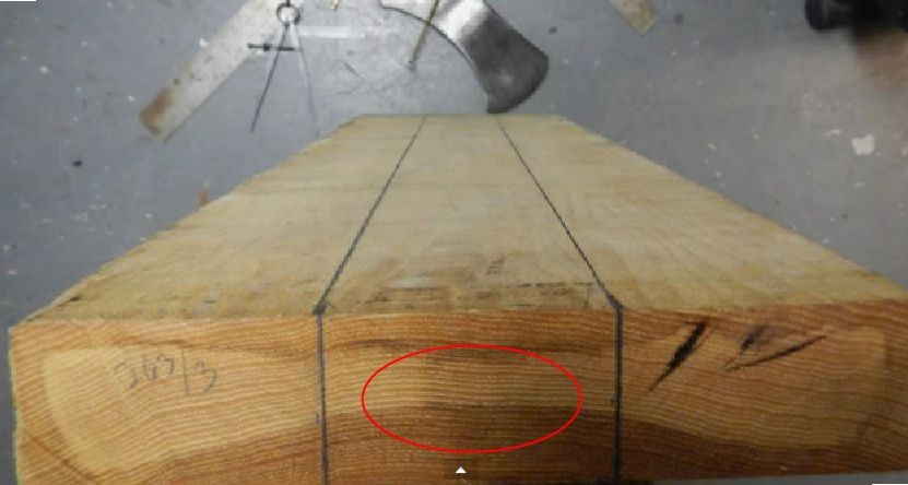

just thought id ask, what do you guys think is that stain around the lumber cross section? it looks like some weathering or something, when i turn the lumber into a handle, the stains remains after working the wood and treating it with oil, thats really weird. When i purchased the lumbers, it was stored Inside.
I wonder if the sawyer 'buttered' the board ends with some inexpensive (and leftover and dirty) wax or oil type stuff. Another thing that often stains wood (part of the reason saw mills often don't want timber from urban areas) is rust uptake from ingrown nails/spikes and fencing.
That crosscut section you can see in the picture is newly sawn as both ends were painted green to protect them, so i presume the stain comes from the outside as it shows the "wet ring" everywhere in the piece of wood.
heres a picture of another handle ive handmade with the same piece of lumber, showing what i mean.
http://www.bladeforums.com/forums/showthread.php/1260696-True-Temper-TB2?p=14434104#post14434104
check the first and third pictures, on the swell, thats not heartwood but said stain.
