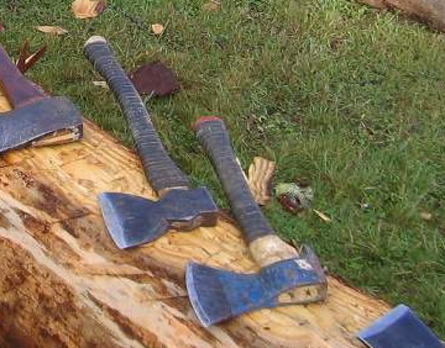

I often find myself choking up on a broad hatchet so I don't think 14" is unreasonable. And having a bit of offset in the haft won't hurt. I have a Stubai (Austrian) broad hatchet with a slightly offset haft. I like it. The haft came originally at about 17" and I re-hung it down to ~15". It's a good length for that tool. The Stubai is the blue one. The other one is a True Temper. They have friction tape on them for grip.

I'm afraid I had to stop reading that thread after page three, I got a bit tired of the "who's the biggest dog" competition, so its good that you started another for your specific questions :D
I only glanced at the pics, but I don't see anything wrong with a fawn's foot on a straight handle if you have the material to try it. But then I like trying stuff and seeing how it works - if you don't like it, you can always make another handle :D Its never a waste of time if you learn something from it.
I am a bit curious how spalted wood will last - you may find it too weak for a good handle. Though spalting can be pretty, it is something I associate with a sub-grade handle for a working tool. I may be wrong about that of course, just something I've never seen or tried myself so I'm making an assumption.
Straight handles have been made with Fawn's hoofs and I personally like the idea. I'm planning to try one myself on about a 16" hatchet, and perhaps a double bit in the future as well depending on how I like it. The spalting in that wood looks amazing in my opinion. Hopefully it holds up. It's probably still stronger than my Pear wood handle that I finished up recently. Time will tell how it will hold up. I can't comment on the hewing axe as I don't own one myself personally, though I need to pick one up for future projects.
