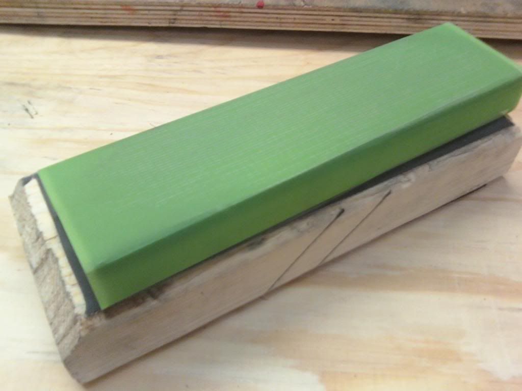

Here are a few shots of my Washboard, used just like a regular bench stone. The first with 30u AlumOx lapping film - used with soapy water has a great feel and grinds very clean - very good feedback through the 3mil polyester backing.

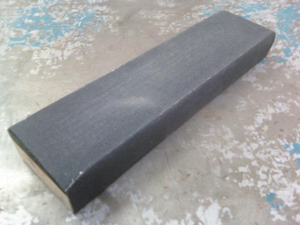

Now with 180 grit Wet/Dry and followed by white compound on paper:

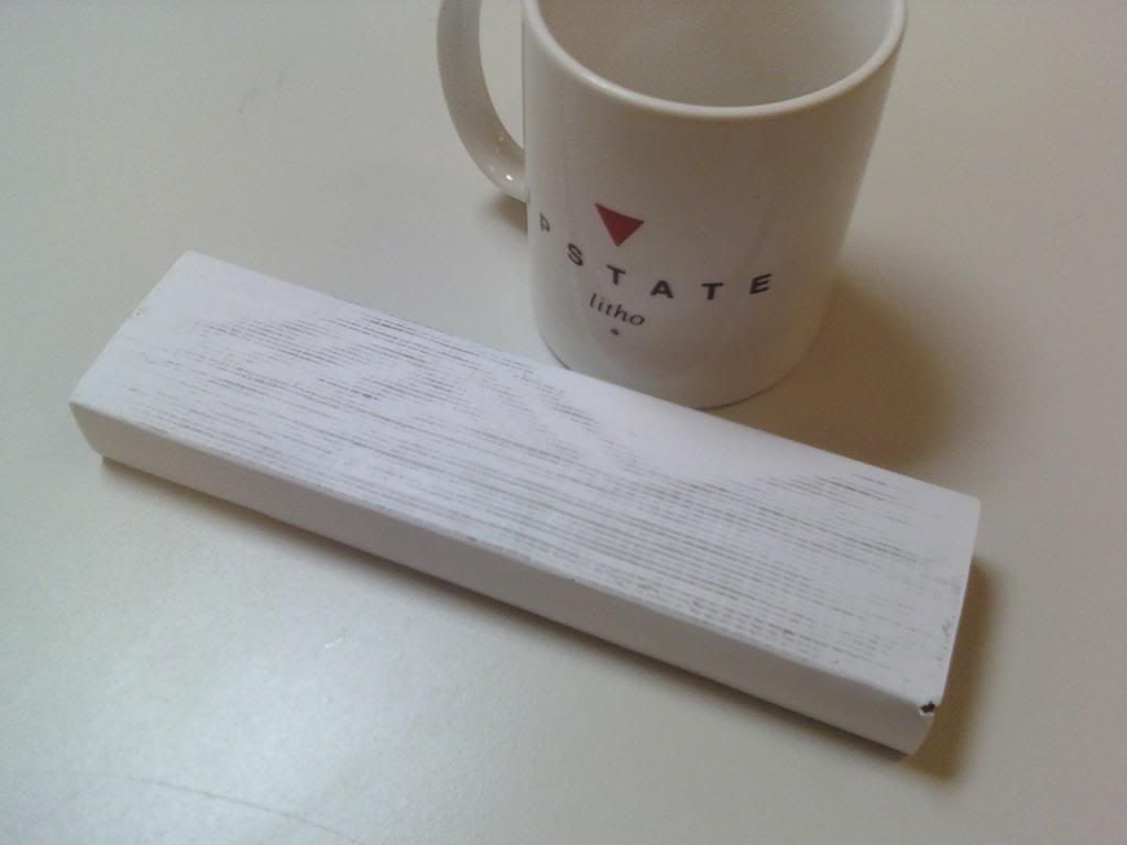

This is what one looks like with no clothes, a block of silicon carbide compound next to it:
