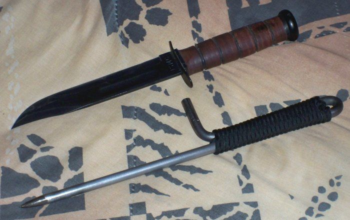

Alright lets see'em. I'm talking about trench knives that look like they were made on the battlefield. Not actual custom made trench knives. The one I have here is a Mosin Nagant 91/30 bayonet that didn't quite just fit on my rifle. So what did I do. Make into a trench knife.

That's a good point. During the renaissance, the Main Gauche was used in thrusting but it still had an edge. So the stiletto was just as a good in combat just without an edge and since it didn't have an edge it was stronger. But I think trying to determine where a knife ends and a shank begins is just really splitting hairs. I actually tried to bend the handle around to make a grip with my nagant bayonet like what you did, which looks awesome by the way, but it wasn't happening. Here's my first attempt at a stiletto. I did it in a forge out of a piece of mild steel and yes the tip was one hundred percent tappered with an anvil and hammer, no grinding at all.

My "forge" is a hand torch that uses mapp gas instead of propane, a bench mounted vice and a piece of 1/2" and 3/4" gas pipe. Very low tech and it requires some experimentation to get everything figured out right, but it's ultra cheap and works fine for the simpler/smaller stuff. For an anvil I use a discarded section of railroad track due to its compact yet strong nature.
One of the French Nails was made by a professional smith for a mild fee. The second was my first real attempt at a proper design and got high praise from said smith.

I used 1018 3/8" round bar stock obtained from the local steel foundry. The original French Nails were made from stolen barb wire steaks, and I really didn't see much difference between the two. So in a way they're historically accurate in material and design.
