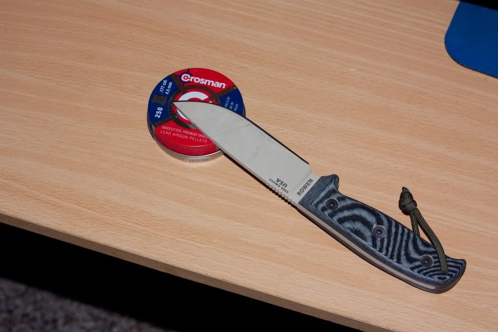

I bought a pellet gun the other day, one thing led to another and now I got some candles...

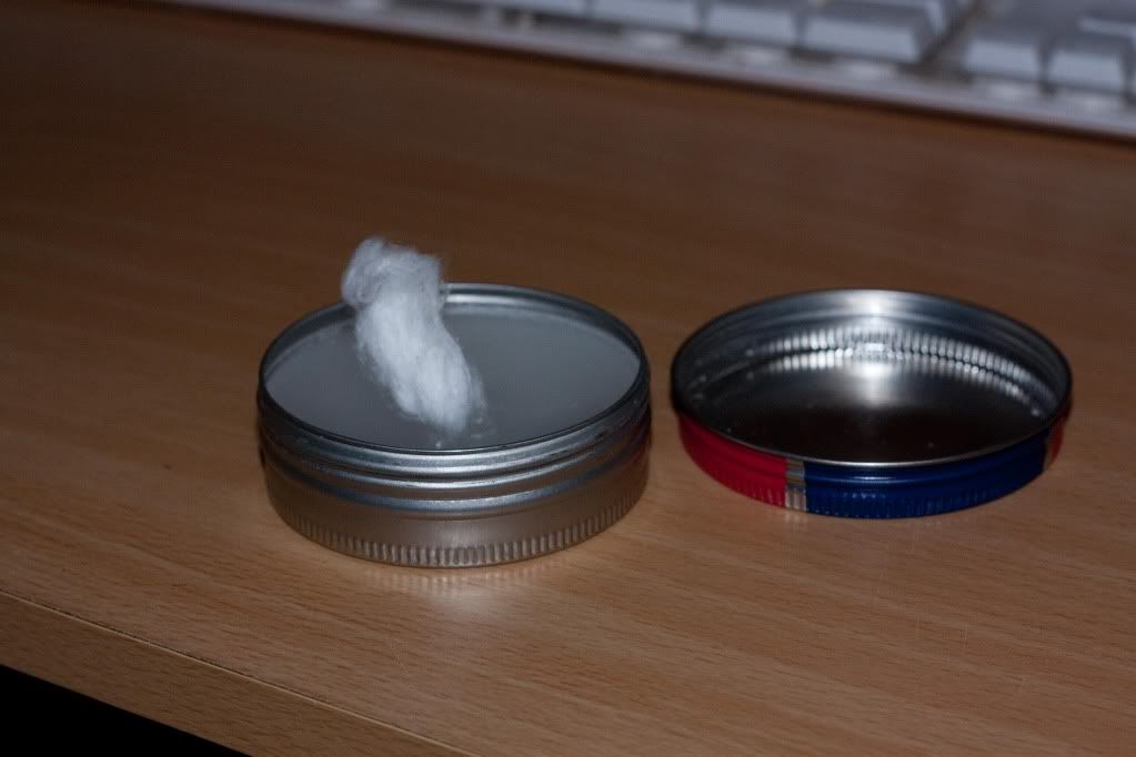

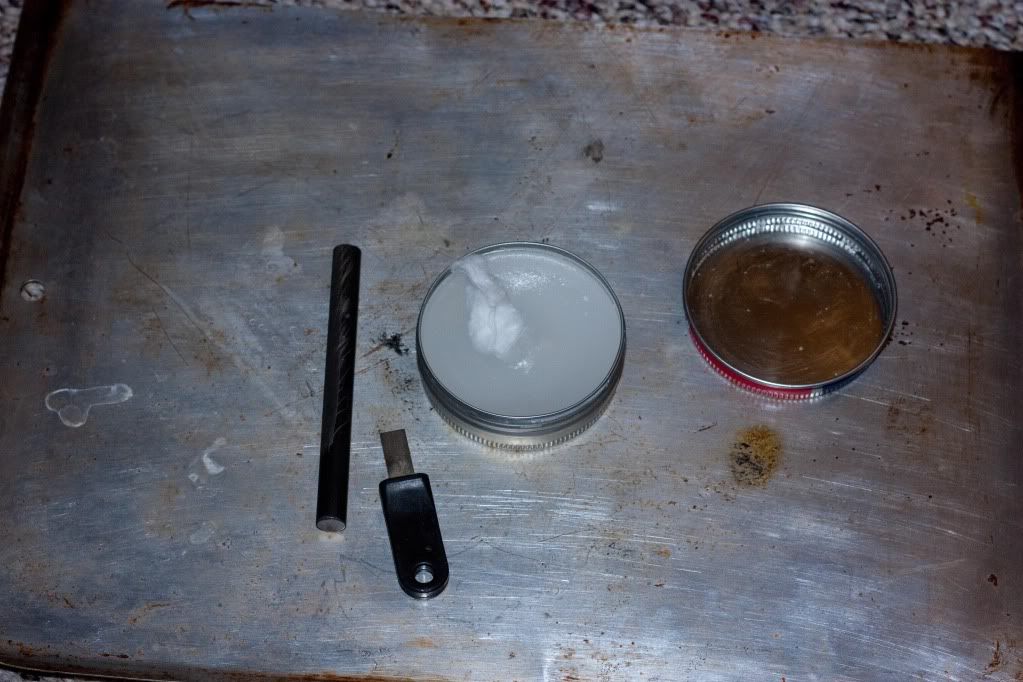

So the pellets come in these handy little cans. I couldn't bring myself to up and throw them away. I decided that some candles would be nice. Most candles aren't likely to take a spark so I decided to get a hold of some super cool, tactical survival wicks (cotton balls.) I melted down a bunch of paraffin wax in the tin, stretched out the cotton ball and rolled it up to make the wick. Suspend in wax, let cool and shazzam! you got CANdle (pattent not pending.)

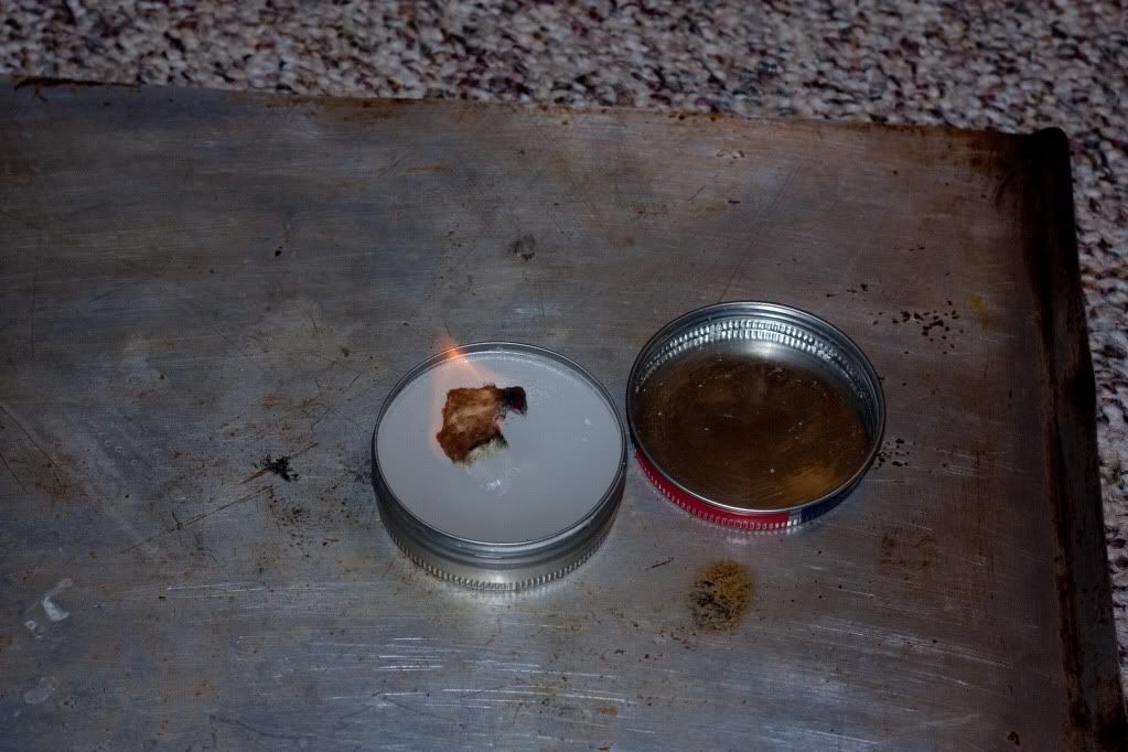

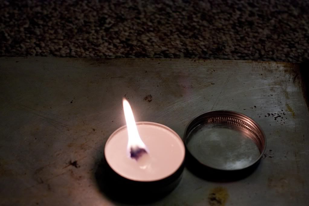

The cotton ball took a spark like a... cotton ball. It lit up, burned high for a couple of seconds and settled down to a good burn. I lit the little guy up around 5:22pm

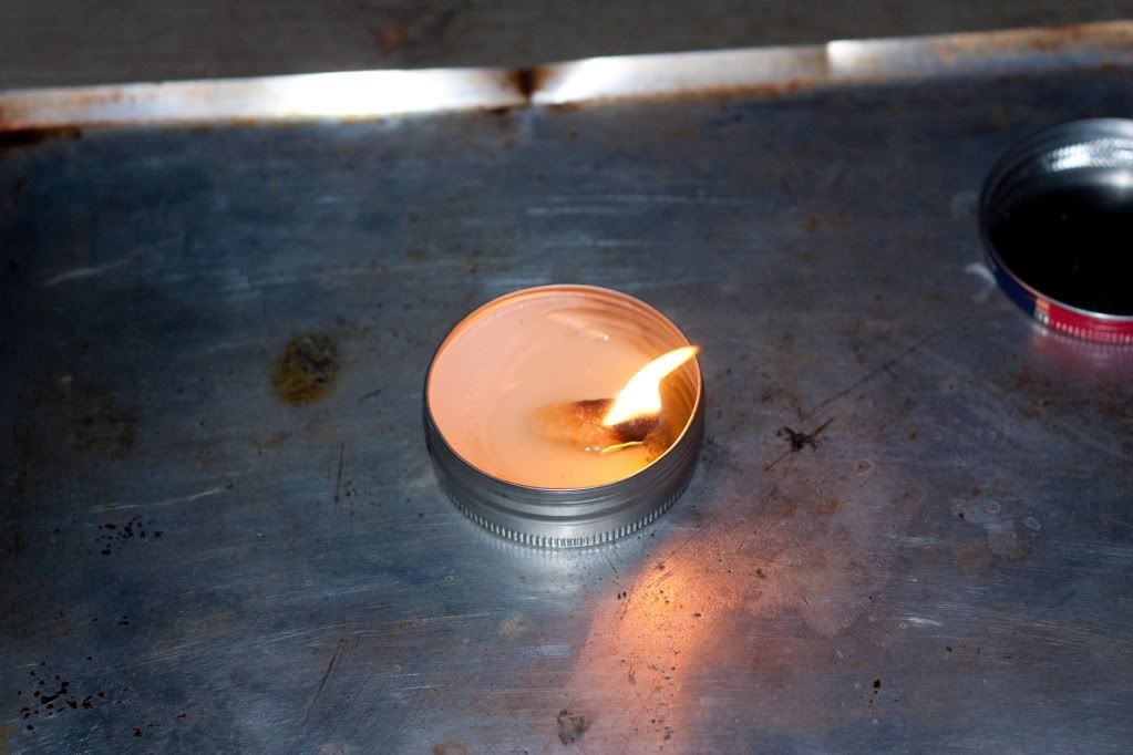

It kept burning well. Around 7:02pm I took another pic. The candle was burning a little lopsided. The wax on one side of the can wasn't melting. Around 8:02 The left side was still un-melted. There was no more melted wax in the bottom. I tipped the can so that the flame was licking up the left side
Around 8:10 I took a look, it was still burning well. The wax on the left was melting and feeding the candle. (This picture does not actually represent this statement. I tipped the CANdle when I was on my way out to pay a visit to my friend, the good General Tso and had other things on my mind.) At 8:32 the General and I returned to find the candle still burning but not wax in the tin. We got caught up enjoying either an episode of Psych or listening to the Sacketts... (I forget which) and forgot to check on the candle again. I estimate from my former experiments with parafin soaked cotton balls that it went another 10 before petering out.
All in all it burned very nicely for at least 3h10m. The cans are nice little cans. I have yet to test them for water resistance and submersibility.
