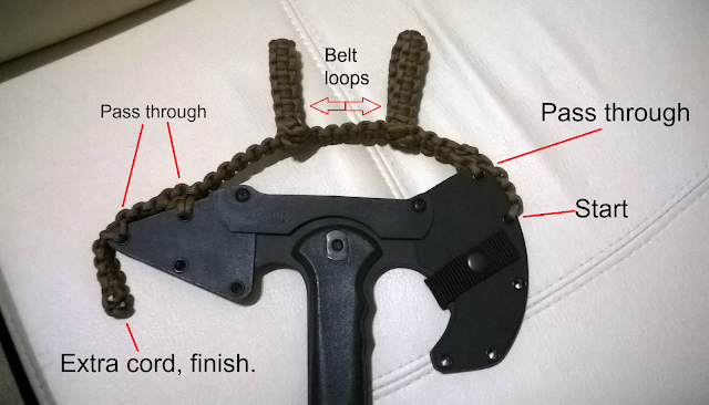

Here's what I came up with:
If you're reading this page, you probably are a big fan of paracord, just like me. 550 cord is just about the best rope you could have for any given situation, especially if you have size and weight concerns in a back-country pack. But we already know that so I'll cut to the chase.
I thought "Hey, since the sheath comes with these holes in it that happen to fit 550 cord, why not just get creative with that and make some belt loops?" So I started with 2 very long pieces of paracord and put a loop through 2 of the holes on the front of the sheath by the cutting edge. I then started knotting them together just as you would make a bracelet out of paracord or hemp. Here's the overview image:

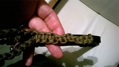

You can see where I started with one cord in the front hole and one cord in the hole behind it. At first I was just knotting one piece of cord, but when I reached the second hole, I started making the bracelet knot. Here's a view of what I'm talking about:
From there you need to stop when you get to where you need the belt loops. You will make each belt loop out of two pieces of 550 cord. You can see here how the main cords wrap around the belt loop cords and secure them quite tightly (same belt loop seen from both sides):
