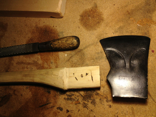

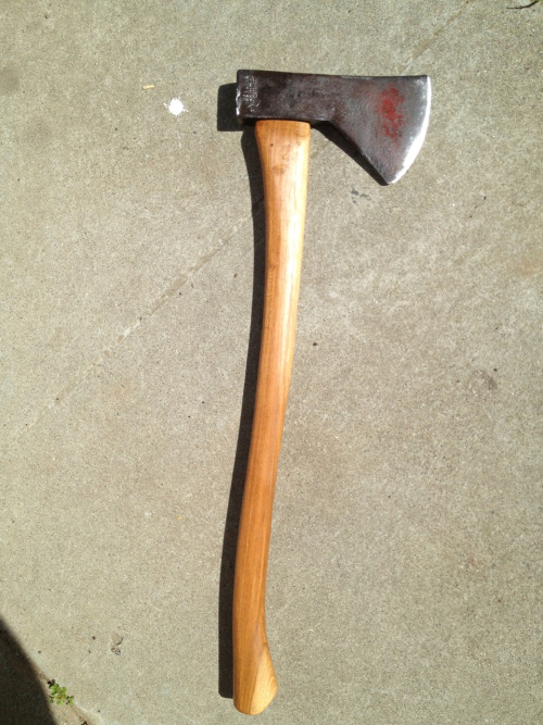

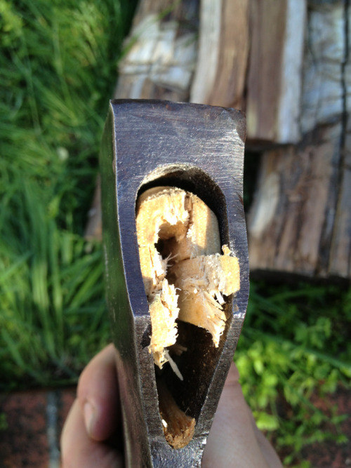

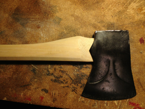

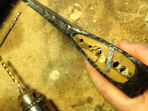

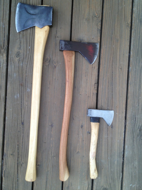

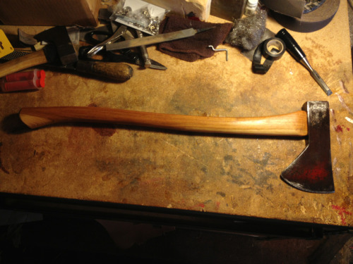

The KP was actually a hang-and-rehang. The first handle was an octagonal 36" that i brought down to 34"

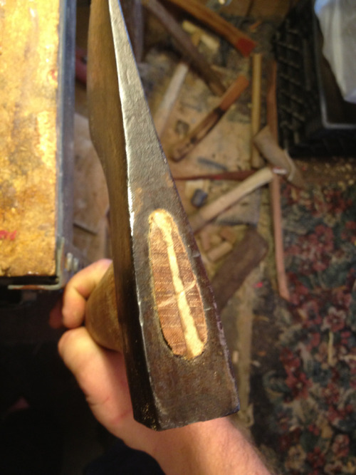

The first hang didn't quite feel right, so i re-hafted it
Removing the first handle

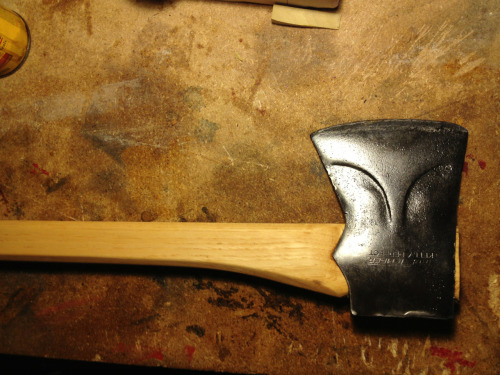

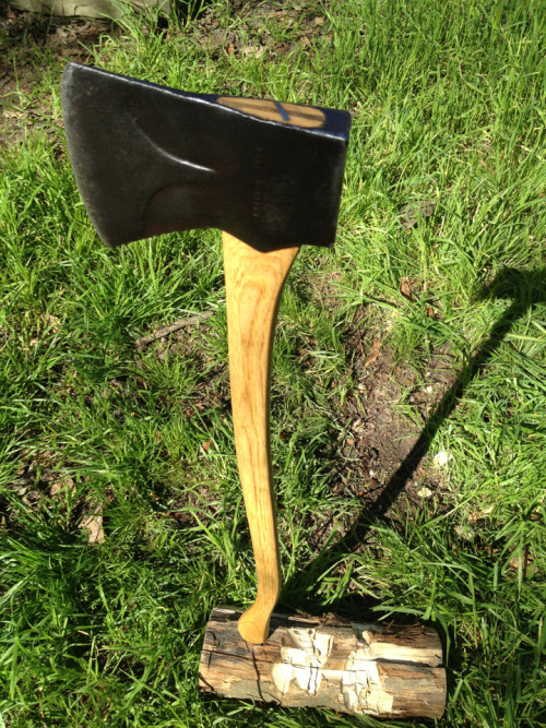

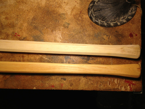

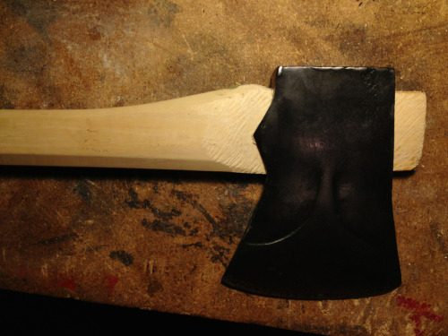

The second handle is a 32" straight octagonal that i brought down to 31"
Reshaped the handle. Took some thickness off the lower end and put a continuous taper from the shoulder to the swell

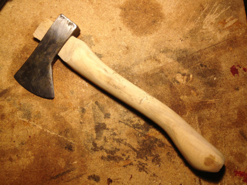

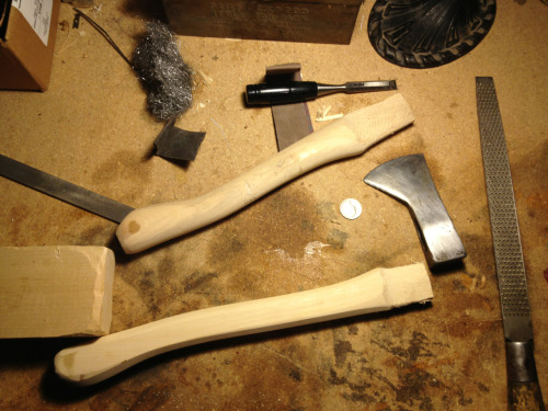

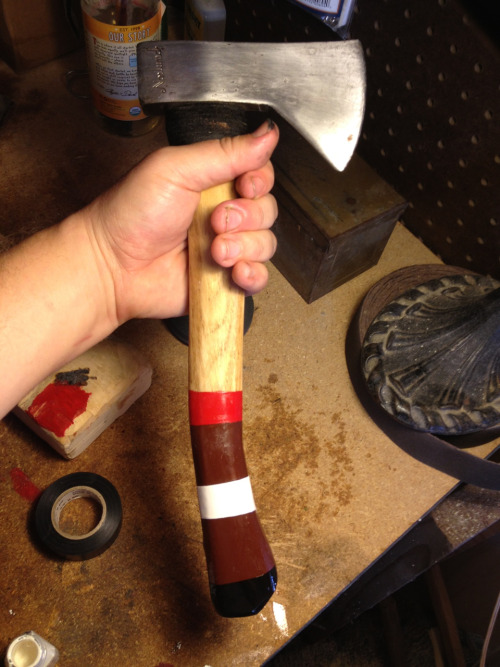

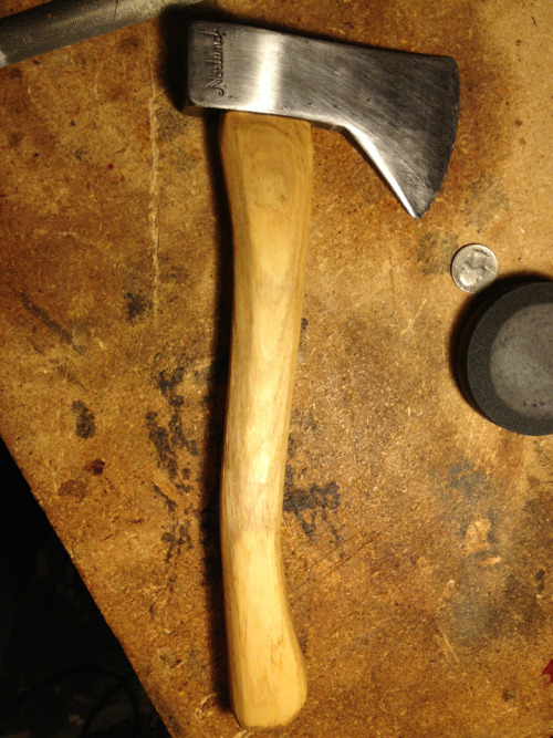

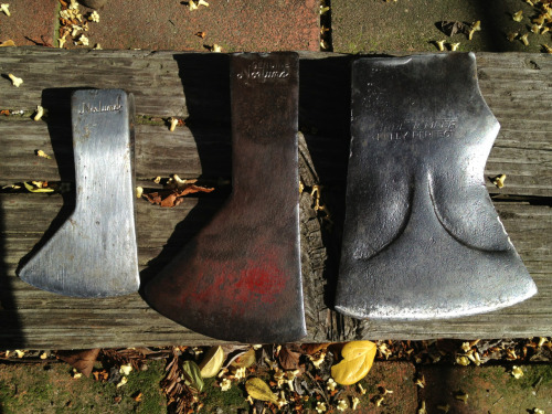

The Norlund hatchet was also a hang-and-rehang. First one was an octagonal 16"

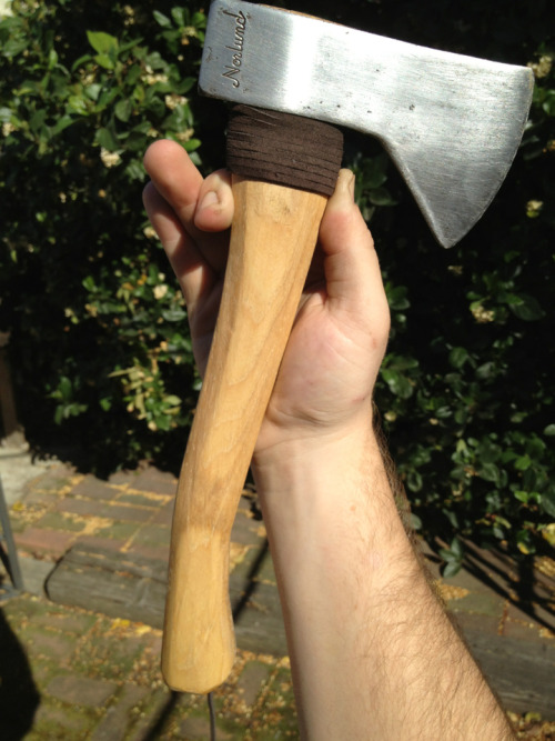

The second handle was a 14" that i brought down to 12½"
Reshaped it and took some thickness off the swell

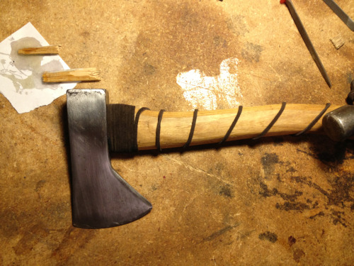

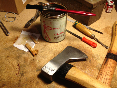

Decided to apply some leather binding for the heck of it
Sealed it to the handle with varnish, leaving the top strand dry where it meets the head

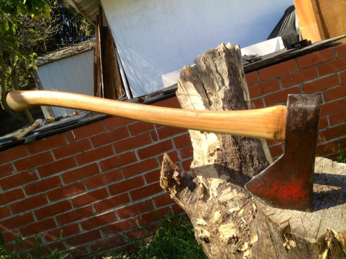

Doing some field testing
Messed around with some striping, but ended up sanding it off. Might repaint it some other time

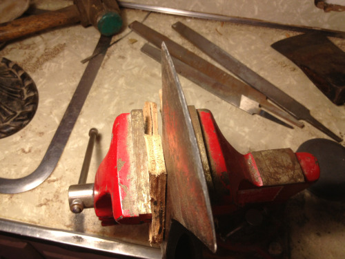

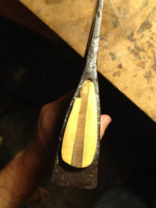

Putting an edge on the large Norlund

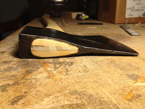

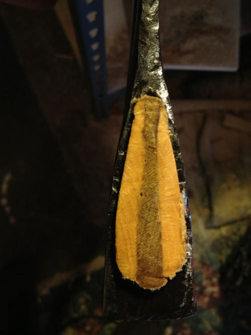

Widening the kerf. (the saw bit me for taking the shortcut doing it by hand instead of putting it in the vice. Probably gonna invest in a band saw sooner than later)

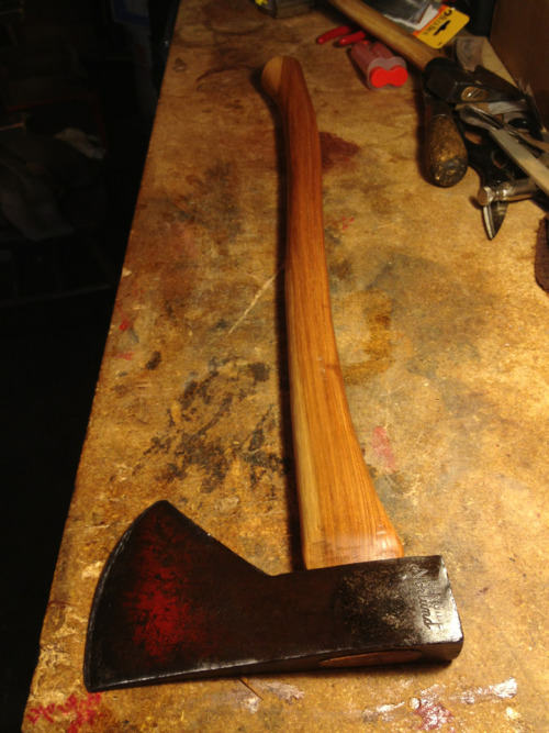

The handle was 28" that i brought down to 25"
Very impressive! I bet that 32" straight octagon Perfect feels great. Those Jerseys are a little harder to hang, aren't they?

One thing I do differently - when holding an axe head in the vise for filing I clamp it by the top and bottom of the eye and allow the bit to lay down flat. Filing feels more ergonomic for me that way.
Those came out great! I love that middle weight Norlund (on the 25" handle). Pretty much my perfect camp axe.
Thanks Peg. I'm definitely satisfied with how the Perfect came out. Yep, they sure are. I learned a lot from hanging this Jersey. And yeah, good call. The horizontal way seems to work better. Thanks for the tip. And seeing your vise reminds me that i need to get a better one as well. The current one i'm using is pretty dinky.

Thanks. It really is the perfect camp axe. I ordered these handles from Tennessee Hickory, O.P. Link company, House Handle, and Crook-Miller Co. out of Hicksville, Ohio. I get handles from various online sources but my preferred and the one i go through the most is House Handle Co.

@WarnerB, How did you get the kelly perfect so black?
My guess is that he left the existing black on the axe by cleaning it with a wire cup brush instead of a vinegar soak. This is why I prefer cup brushes to vinegar. I like the brass cup brushes best because I think they leave a little more of the patina intact than the steel cup brushes do. But they take longer to remove the rust.
