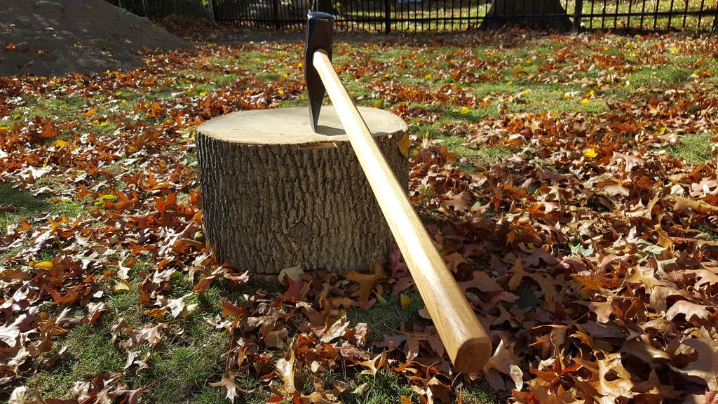

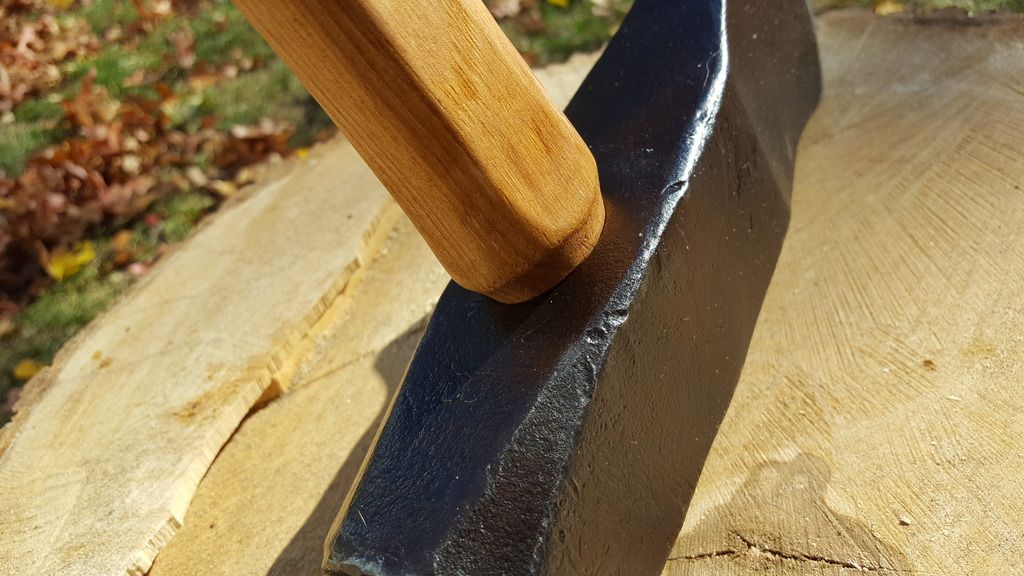

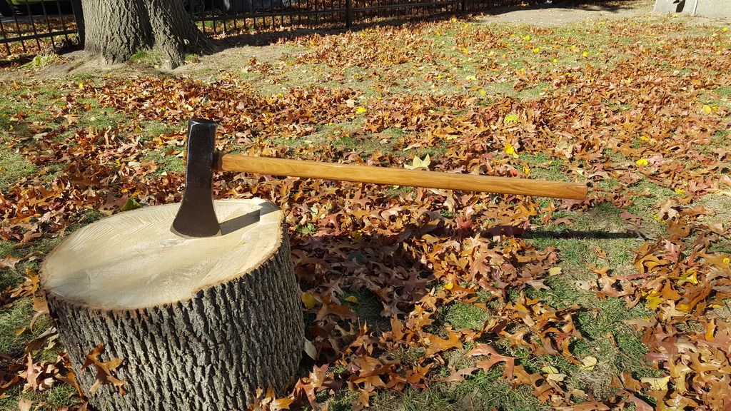

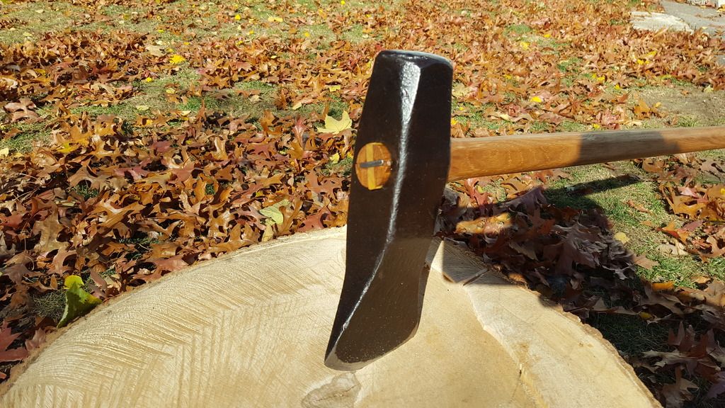

So, I spent an hour and a half this morning hanging my splitting maul. I think it came out ok, but I'd love some critique. I used a bench sander and a rasp to shape the haft. I got it pretty close to the shoulder, and I think it fit pretty well. As I said earlier, the kerf was far from in-line, but I chose the handle with the best grain that they had. The lacquer was a real pain to get off, if the handles I ordered from househandles are any good, I think I'll end up preferring to wait for those rather than do all that work again. As you can see in the pictures, there's a few spots where I didn't fully remove the lacquer and the BLO didn't soak in, I've since sanded those spots more and re-applied BLO. I thinned out the handle by sanding flats onto the sides, creating a sort of rounded octagon. I felt that it was too thick as it was from the store. The only thing I don't like was how the metal wedge cracked the haft a little bit. I don't think it diminishes the strength of the hang, but I would have preferred that it didn't happen. And finally, a picture of my new helper.

This is probably the last sledge hang I'll do for a while (all the next hangs I'm going to do will be axes), but just so I know, is there something I can do in the future to prevent the metal wedge from cracking the sides like that? Was the wedge too wide? Should I have ground it narrower by an 1/8" or so?
Many of us forego the metal wedge for exactly this reason. A metal cross wedge will almost always split the wood. The jury is still out on whether they are beneficial or not. I think they're best left as a fallback position to be added later if necessary.

looks fine to me, looks like you got a good bite with your wedge

Good work, one thing with the metal wedge, it should have gone more inline with the grain / more inline with the wooden wedge, not cutting straight across it.
That's ideally... I realise sometimes you need to wedge it how you need to wedge it to take up space in a particular area.
But yea, if the wedge went more inline with the grain it would instead wedge it outwards as the wedge will go in between grain structure, and not sever it. It probably would not have cracked as it did.
Very good work though, im sure it will serve you (and probably whoever you pass it down to), well!

Ah, I thought it was supposed to be perpendicular to the wood wedge. As I mentioned above, all my future hangs will probably be axes and hatchets, which I'm going to try to do without glue or metal wedges.
