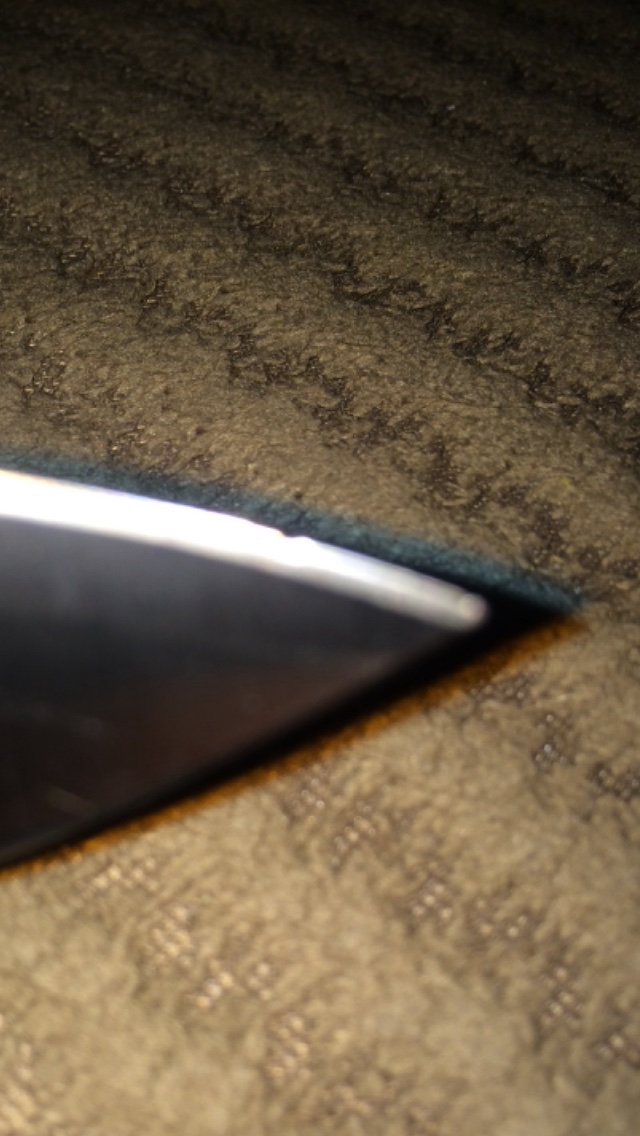

So my HAP40 Dragonfly 2 has a chip a quarter inch from the tip. Only lightly used this knife a few times. Second owner, so does that void any remedy/warranty from Spyderco?
Im a big Spyderco fan and this is my first issue with any of them but geez, its disappointing. I was gonna trade it for a serrated edge which I prefer in their small blades but now its been devalued. 😕👎
Anyone have an issue with HAP40?
Anybody know if I have a chance with warranty being second owner?
The warranty still covers you as the second owner, but what do you want warrantied? A chip in the edge? They don't do that. Is this some big chunk of missing metal or something that will come out after a few of sharpenings? If the latter, then just sharpen it out.
I suspect it would only be covered if the metal was defective, like bad heat treat. I doubt that's the case but you can send to Spyderco and see.

That doesn't look like a very big chip. I would just sharpen it out and it will be fine. It looks like you may have come into contact with something like a staple while cutting a box or something.

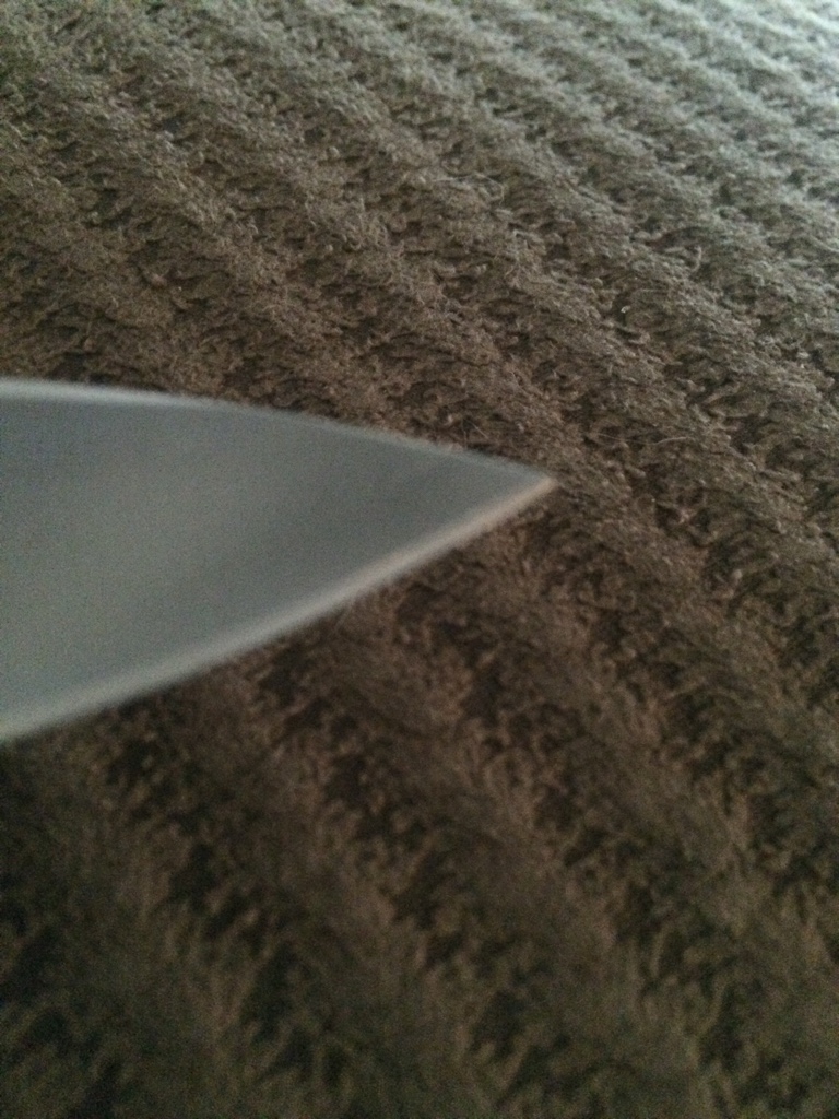

not the best pics but I just sharpened it out. itll be a perfectly fine user...
I think you could still sell it as a lightly used and sharpened knife but I would keep it myself. There might have been a little stressed steel on the factory edge. I doubt you will have any more issues now that you've sharpened it and it really is a great steel. Enjoy.

It's a great steel, just sharpen those chips out. You could also send it back to Spyderco for resharpening--I don't think they charge for that service, other than postage. I'm pretty sure they will regrind it back to perfection. If they found something wrong with the heat treat or whatever, they would probably take care of that too, but I bet it just needs a light regrind. I've used the heck out of my 2 HAP40 knives, a Delica and an Endura. Can't say enough good things about them.
Oops, I see you already sharpened it out. I bet you find it to be more than satisfactory. I would consider myself lucky to have any HAP40 Spyderco, they are getting pretty rare these days.

And I know you removed the chipped steel but after getting some sleep and looking at that first photo again I am thinking it may have been seriously dinged and folded and just looked like a hunk was missing. Any chance that is what happened ? If so a fatter sharpening angle would help it stand up. I have seen that quite a bit in wood working chisels and a wider angle eliminates the problem.
