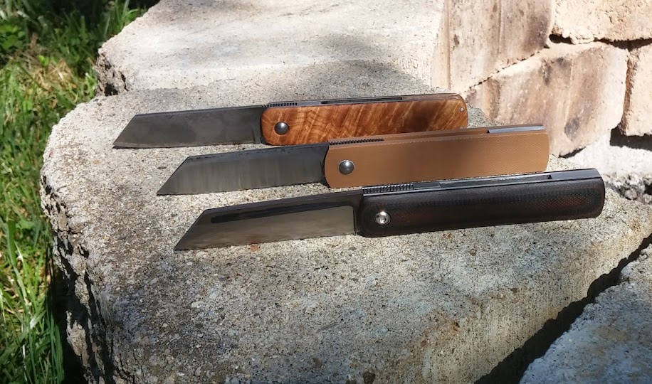

Red/Black (Blue??) micarta friction folder I just finished this AM. Will be headed with me out to the river and some beers.

Hi guys! Thanks for the nice comments. The construction is 1084 blade, stainless liners, 3/8 pivot and red/black linen micarta.

I response to more photos, I snapped a few extra this AM along with a few others I've done. All are 1084 carbon friction folders with brass washers and 3/8" adjustable tension pivots.
One is in Black Ash Burl wood and backspacer with stainless liners. This one I put a dull patina on the full blade. Exposed pins.
One is red/black linen micarta with stainless liners and 1084 backspacer. This one I left the heat scale on the blade other than the bevels. Hidden pins
The last one is tan G10 with no liners and 1084 backspacer. This one I did a light patina with satin bevels. Hidden pins. *I still have to recess the pivot on this one.
I added a my GEC #72LB for size comparison. Apologies for the picture quality.

Thanks guys. Yes, the blades have a slight up sewpt belly. I didn't want a true tanto/wharncliffe straight edge. But there is always next time to do another variation.
