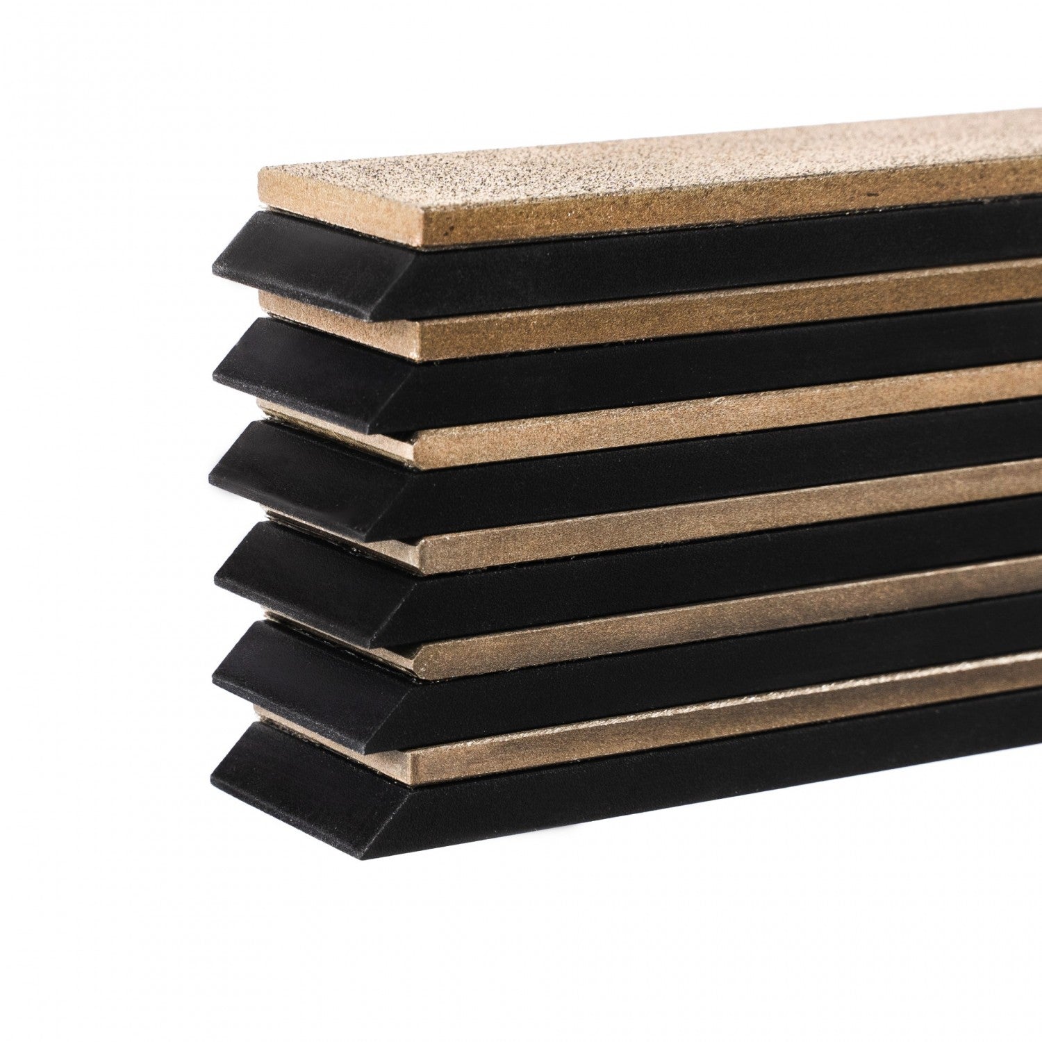

Hey folks,
I’m thinking about trying the Hapstone Premium CBN stones. Mainly as a more cost effective alternative to Venev metallic or Poltova. It looks like those stones still have the square ended backing plate. The stone holder of my Kadet pro already has the groove on one side, so that any EP form factor stones fit really well. Would the square ended stones still connect as securely?
I understand that “back in the day” all the Tsprof models fit those better, but as securely as the new upgraded version holder?
Thanks for letting me pick your brains again, guys.
I am seeing beveled ends on the Hapstone USA product page.
Hapstone CBN stones, both regular and premium, work on TSProf sharpeners.
TSProf stones fit Hapstone sharpeners, but the TSProf stones are too thin to work well with the Hapstone stone holders.

The Hapstone premium cBN and the Poltava metallic bonded cBN are the same.
They are both metallic bonded.
They are both made in Ukraine.
They are both made by Poltava.
They look different. The Hapstones are shinier.
They feel different. The Hapstones are smoother.
They sound different. The Hapstones are quieter.
A Poltava premium CBN 120 cuts faster than a Hapstone premium CBN 120, 80, or 50.
The Poltava premium CBN stones are 2mm thick, not counting the backing plate.
The Hapstone premium CBN stones are 3mm thick, not counting the backing plate.

How the stones are dressed makes a big difference.
A Poltava premium CBN 120 cuts faster than a Hapstone premium CBN 50.
That's true even if you use a Hapstone Premium cBN 150 and a Poltava Metallic bonded 50.
There's more going on then meets the eye.

The scratch pattern and function are the same along with the maintenance and dressing.
