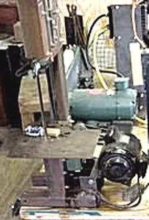

Balin, you need to take the guts of the saw and do what I did, make a stand up band saw with them!
You're so limited with the horizontal saw and I got sick of using it so I took the working parts off mine and took some 2" square tubing and 3/16" plate and made a regular saw. It worked great for me and still does for my neighbor. It's real simple to do the conversion.
Here's a bad picture of the saw I made. This was when it used 63" blades. After a year or so I put a longer section of 2" tubing on it so it would accept 10 foot blades. It cut a lot more efficient and the blades last for ever!

That conversion rocks!
I gota make one of those!
