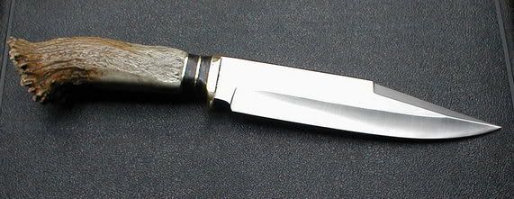

The ones on my forum are a mix of the old and new. Just finished this one up that is more in the "old" style.

I sure like this.... it is beautiful!
