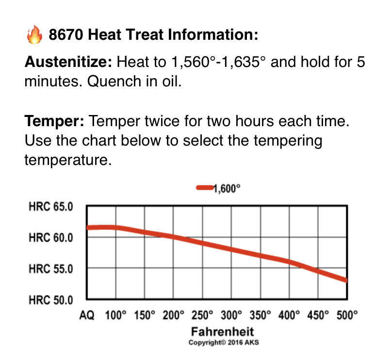

Just about to do this for the first time.
Happy with the high temp of 1525 F, and oil quench.
But unsure on tempering and timings.
Should I temper straight from the oil quench? or wait? or what?
i will be using a domestic oven that goes to 600F (at a pinch). Do I pack the knife in a sand tray? How long at what temps?
Thanks for any help
This is info from Alpha Knife Supply
Yes you should temper straight from the oil as soon as it’s down to able to pick it up with bare hands temps in order to lessen retained austenite. Anywhere from 325F for a kitchen knife to 400F for a harder use knife depends on intended use. Two cycles at 2 hours each. I don’t use a sand tray but my oven is pretty stable.

This is a largish bowie knife for general outdoor use, I'm thinking 300F going on the chart above?

That chart from alpha knife supply is wrong for our application and they have said it’s not correct for our use so no idea why they leave it up to confuse people, I’m using a lot of 8670 and for choppers or heavy knives I temper at 375, I like to do my first temper cycle lower than my final number so my first cycle I’ll run it at 300 for 2 hours cool the blade in running water once you pull it out the let the oven come back up to temp at either 350 for small knives or 375 for bigger knives for another 2 hour cycle cooling it with water after I pull them out. If you left a chopper at 300 it would be around 63hrc

The ideal temp for when the blade hits the oil is 1525 so bring it up to around 1550 cause it will lose some heat in between your oven and quench tank you don’t need a full 5 minute hold or soak with 8670 2-3 minutes is fine. I use parks 50 to quench and I put the blade in for 7-10 seconds then pull it out to clamp in between plates so nothing warps or moves, let it sit in the plates for a few minutes then go into the pre heated oven to temper once the blade is cool enough to handle. I’d suggest bumping your second cycle to 375 instead of 350 it will give you a bit more toughness for a larger blade and still hold a great edge. I can take a camp knife with a hollow grind and chop through 1/4” brass rods with no edge damage and can cut into mild steel rods without dulling. I’ve made over 60 knives with that exact ht recipe and have had consistent results between them all. It’s a very simple steel to ht and is probably the toughest knife steel you can use.

Larrin's book recommends 1,525F for 10 minutes, quench in medium/fast oil.

I would agree with everyone saying higher temper than 300F for a Bowie. I use 8670 quite a bit and I’d agree 375-400F for this application. I also use 1525F since I go off Larrin’s research.
