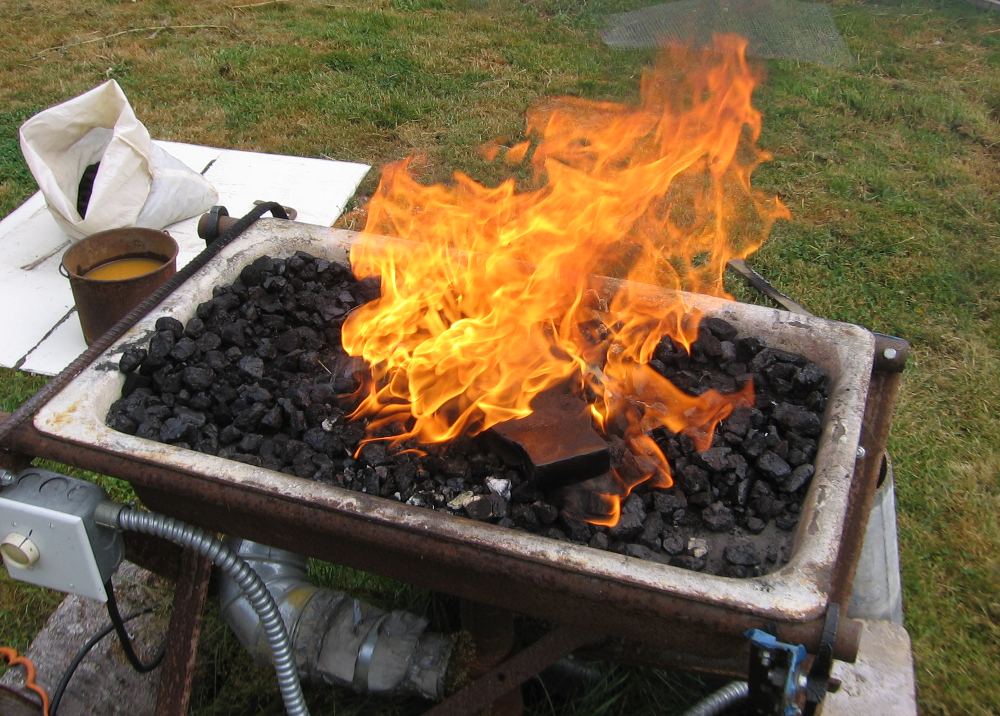

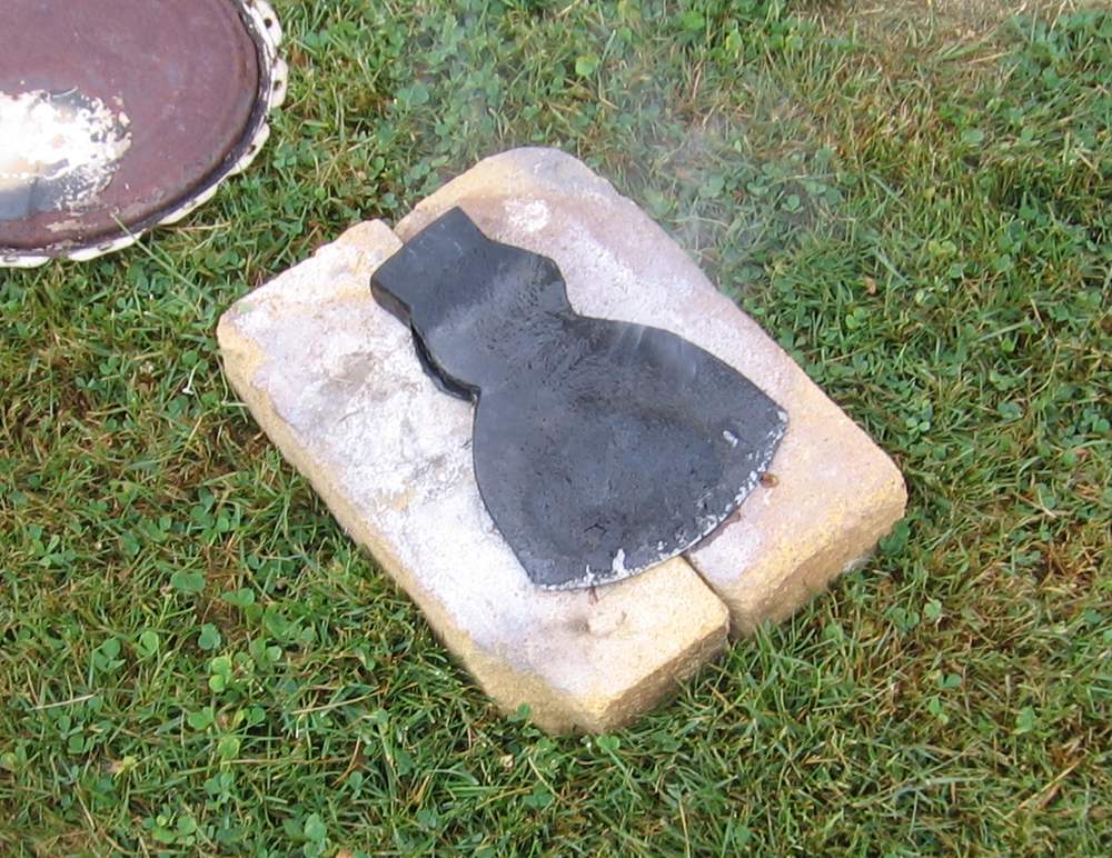

I re-tempered my masting axe. I'd had a repair done by a more skilled smith. Brought it to non magnetic,
quenched in canola.
I tempered it in the kitchen oven. I cleaned one portion of the bit so I could see the temper colors when it came out of the oven. I let it cool completely before file testing. I started with 1 hour at 450°F and found it to be too hard to file. I gave it another hour at 475°F. This produced the purple/brown temper color I was looking for.
Still, I found this too hard to file even with a good sharp file. So I gave it another hour, this time at 500°F. When I brought it out I saw blue at the tip and thought I had ruined it.
This turned out to be perfect, fileable but still quite hard. That blue temper color would represent about 560°F in some other steel.
The thing is, if you don't know what type of steel you're working with you can't know what the proper temper should be. But if you start low and test after each temper heat you'll eventually find the temper you seek. Patience.

Square_peg,thank You,sir,for the neat,concise photos + instructions.(alas,i seem to totally lack any gift to speak Plainly...it's painful to read back over my own text...).
