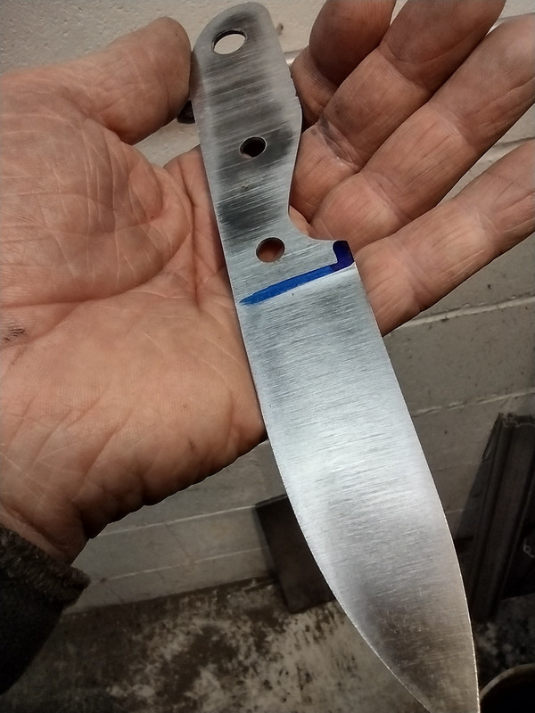

I still occasionally LOVE to make knives out of Very Hard..... Power hacksaw blades.
Hereis one I'm actually making literally Now.

Right now I am grinding 1095 bar stock.
