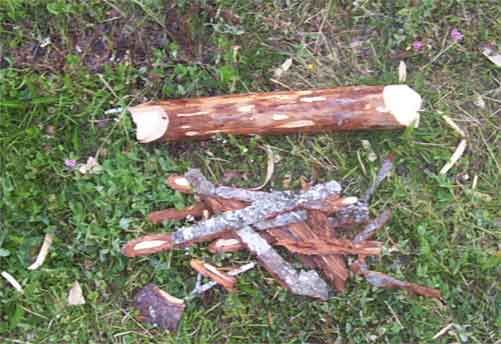

Trying some slighter chopping, the performance was much the same in that the Bruks was way ahead. On springy alders the performance was even more significant in favor of the Bruks which could pop off thick alders with a quick snap :
The hardware store axe on the other hand tended to break the alders, the edge is just far too obtuse :
