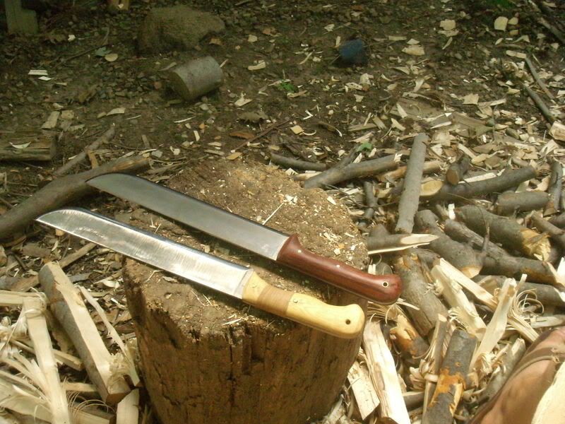

12" blade, 6" handle. 1.75" wide, 1/8" thick S7 heat treat by Paul Bos to 57 RcH. maple scales with brass hardware.
pre-handle testing:
here with its prettier brother in cocobolo with brass:

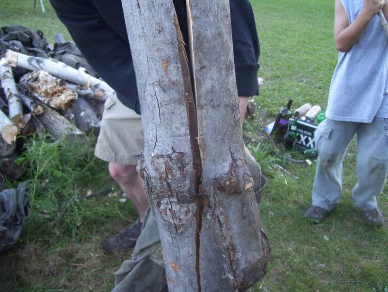

now onto the attempted destruction testing:

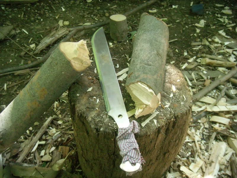

It started out with a maple handle, but I destroyed it during testing part 1, beating the whole thing through a large log with a masonry hammer. The photos are from part 2, where I beat the blade through a larger, knottier log with a large iron tamping bar. Part 2 took two people, myself and Theo Newman.
here you can see the blade going straight through a huge knot:

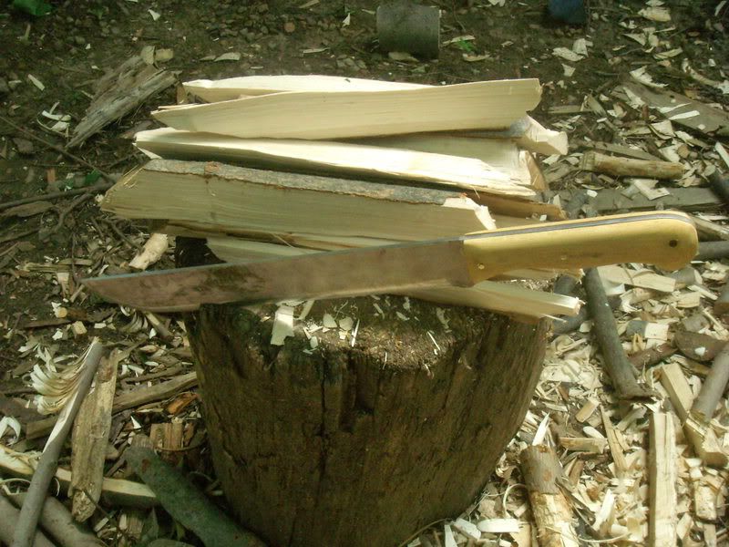

After testing part 1 and 2 the edge was still shaving sharp. Not too surprising, but I expected the knots to dull the blade at least a little bit.
Flex test. It returned to true after bending it a little farther than shown in the photo. I would estimate we took it to about 70 degrees. We didn't want to try any farther because noone was wearing safety equipment and we didn't want to risk injury. And we were satisfied that this machete would hold up to just about anything at this point.

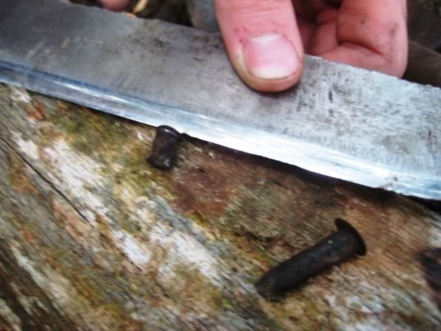

Two weekends later I was camping with some friends and we found a shovel that i wanted to try fixing up (the handle was broken off inside the socket). Not having proper tools, I used my machete and a 2.5 pound sledge to cut the 1/4" mild steel pin that was through the socket. This resulted in some edge deformation, but no chipping. The edge damage could be fixed in a minute or two with my regular sharpening setup or a file and a sharpening stone.
After pounding on the spine of the blade with a masonry hammer, iron bars, and a small sledge, the only damage to the knife was that the spine is deformed and mushroomed. The edge has held up well to impacts with common things found in the woods and with things that should never be cut with a knife blade. Overall I am very pleased with the way this machete performs, and I intend to continue making these.
