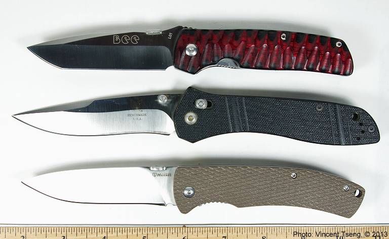

Size comparison -
with the BenchMade BM-710 Axis and the Enlan Bee L01-MCT that I recently reviewed.
My first impression it was about the same size as the BenchMade 710 Axis -
but as the photo shows it is not - although it is bigger than the Enlan Bee L01-MCT

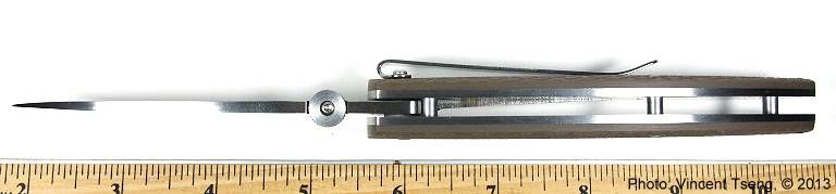

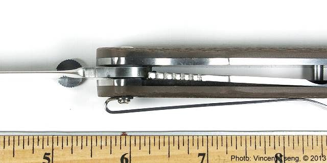

blade is centered - and depending on how one looks - with a very slight bias away from the liner lock (also see later)
alignment - the liners are thick.
Measured 0.077" thick at the liner-lock using a digital caliper - but by eye and simple ruler at the back, the liner measures approx ~3/32" thick.

lock-up is solid and almost full width of the thick liner.
No blade play whatsoever when locked open - no problem with the spine-whack test.

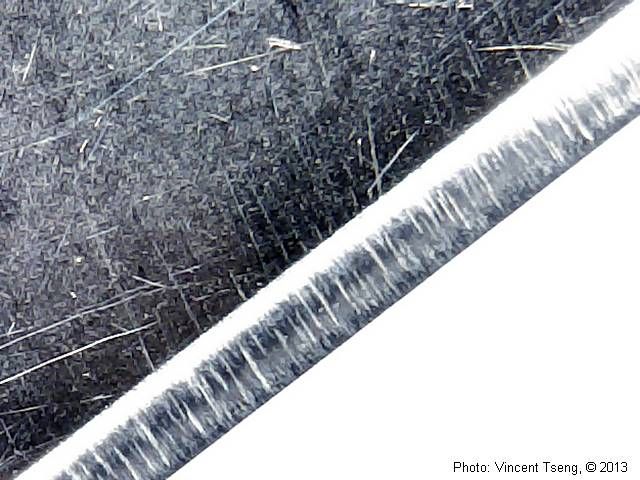

(2) my sample was not that sharp -
I have seen a video review that said it was the sharpest knife they've ever bought -
I am not doubting that - but mine was not sharp.
usb microscope pic (~110x) of original edge - it was "OK" but not too good.
I took it to my Work Sharp (belt grinder) Knife Sharpener to grind in a new 20 deg convex edge
and finished on the Work Sharp Knife & Tool Sharpener - Ken Onion Edition
much better - and one can see that high polished sheen on this edge pic (usb microscope about ~110x)
now the knife is really, really sharp and cuts through really well.

Here's another good looking/finished edge under the usb microscope -
it's Victorinox steel again -
this time on a Victorinox Fibrox Santoku (kitchen knife), again at 20deg/side.
