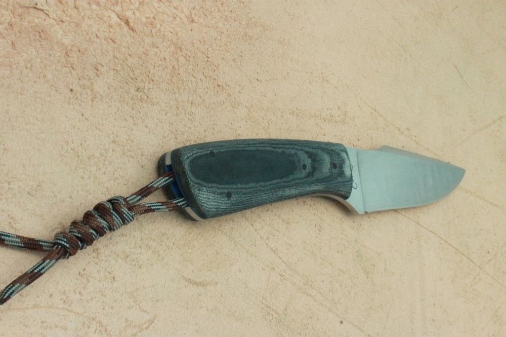

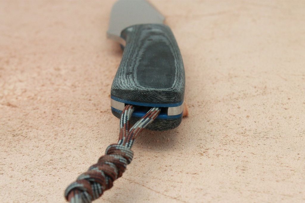

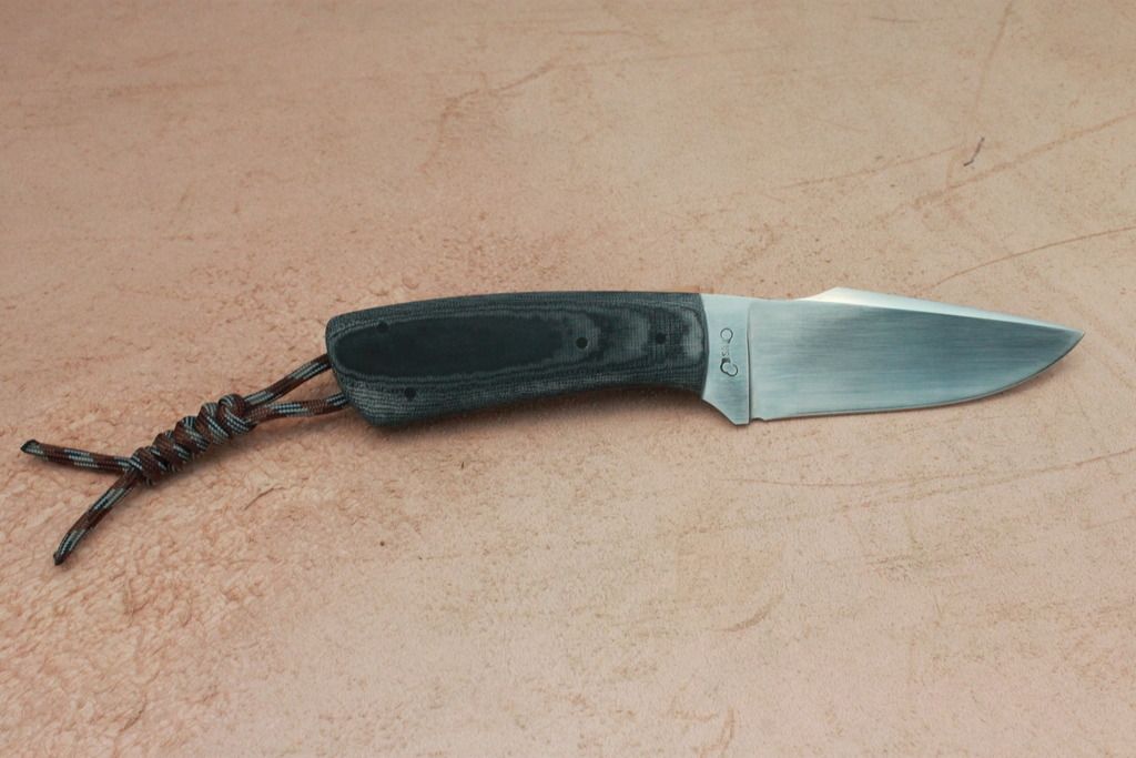

Here's my first blade in stainless steel. It's a tactical EDC style, with a harpoon clip made from CPM-154. The handles are black linen micarta with blue G-10 liners. It also features a hidden lanyard hole.
OAL: 7-7/8"
Blade length: 3-1/2"
Thickness: 1/8"
Hand rubbed 600 grit finish.
Carbon fibre pins

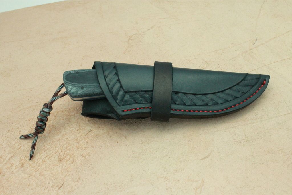

Black leather sheath
Let me know what you think :thumbup:
Not bad at all. Good basic all around knife, with clean lines and a very utilitarian lanyard. Very cool!
in a raised spine like that. i want the butt of the raised spine close enough to the handle to make a thumb ramp. the choil behind the edge, on the other hand, should be sharp and perpendicular enough to brake the leading finger, whether in a regular or reverse hold.
Thanks guys.
Hank, the harpoon does double as a thumb ramp. I'm not sure I understand your other comment though
Thanks for looking.
