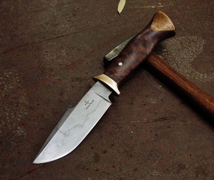

This one had several firsts for me. I was finally able to get my hands on some W2 for the first time and it was mostly a pleasure to work with. I have a piece big enough to get two knives out of and this was my first one. I did an oil quench on this one but will be trying brine on the next. Also this was my first time trying a harpoon point on a knife which I can tell will now be a regular style I will use.
The handle is made of curly walnut and curly maple with bronze guard. This is a tough fun little knife, and I look forward to hearing what you all think of it.
