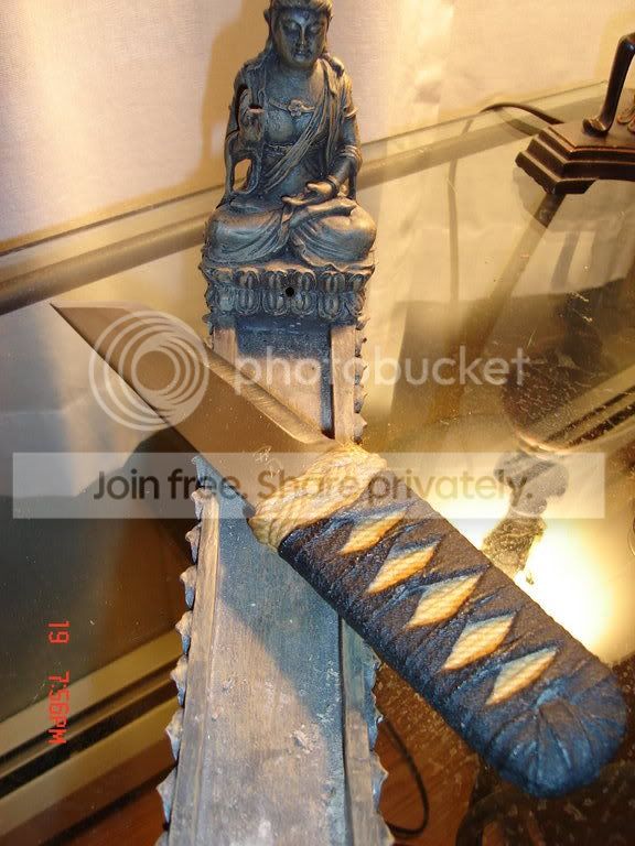

I've been admiring the work of the late Phil Hartsfeld for a couple of years now. I would like to try to make a couple of knives like his and was looking for some information/opinions from owners/users of his blades. The bevel side is almost always shown in pictures. What does the back look like? Is there a microbevel, hollow relief grind, true chisel grind (lapped on the same finishing stone as the front bevel), a full secondary bevel, or other? Any approximations to the angle of the bevels? Did he use just one bevel, or change to suit the use? I know he made his knives from A2. I have some A2, and also just aquired some M2 from a fellow member here. I've used M2 in a couple of knives before, and like it a lot. I'd like to make a small edc type blade, and a larger fighter style. All comments appreciated.

Here is my commissioned piece in 3/16 thick A2 taken to 62.5 HRC:
