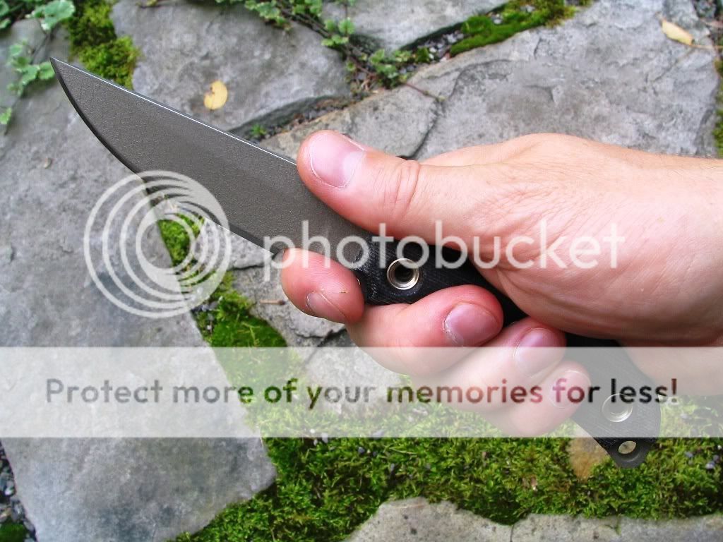

There is a Hack GW with big choil replacing the front talon hole and small choil. Pic in the FS section today, not sure if I'm allowed to to reference a sale item here but I'm not trying to sell it... Was thinking of buying it.

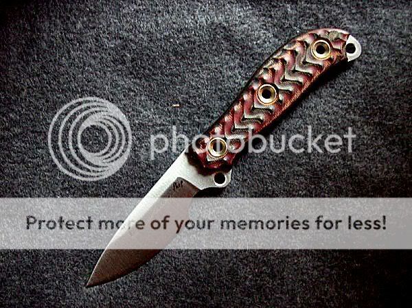

I did the same thing as P-Easy (Meaner Street but still):
As you can see, I modded the butt as well so now the handle feels exactly like an Active Duty. I really like the bigger choil; feels great in hand! I'd prefer no choil at all on a knife of this size, but I find the finger-sized choil is the second best option (as opposed to an "in-between" like the current AD or Meaner).

That GW HACK feels great in hand with that big choil...if only it had been skinny, I would have kept mine. :grumpy:

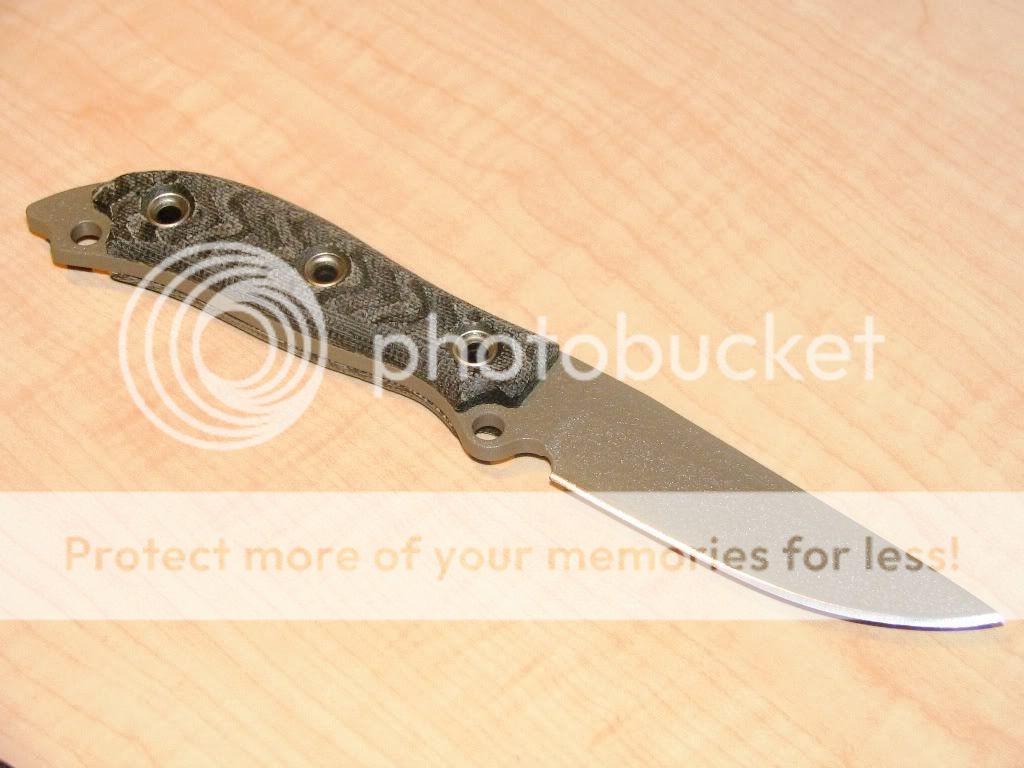

Here's an ugly mod I made to my Milganza AD. I removed the talon hole. This allowed me to keep the full cutting edge.

I really like that! Nice work.:thumbup:
This is EXACTLY what I was talking about! How does this feel vs. the original? I was worried the handle may be a bit short (edge to spine) in that area, buy yours looks good. Good work.

Sorry...just to check...is the snakeskin pic above an actual modded knife or a photochop? It certainly looks an amazing modification job if it has been done.:thumbup:
I would assume its a Photoshop job. Would love to have one like it though,,,:)
Now that IS a lovely job...:thumbup::thumbup: Did you get the custom shop to do that? The coating looks like it has been fully re-done to cover the mods? If so...would you mind giving a ball park figure?
Hey Peter - thanks bro.
Nope, did the mods myself. The trickiest part was to go REAL slow for the choil, keeping a finger on the edge and dipping the blade in a cold water bucket every time the slightest heat could be felt on the finger (every 15/20 seconds or so). The butt was a little easier, although I didn't let it get hot either. The slabs...well...no HT messing there :p
