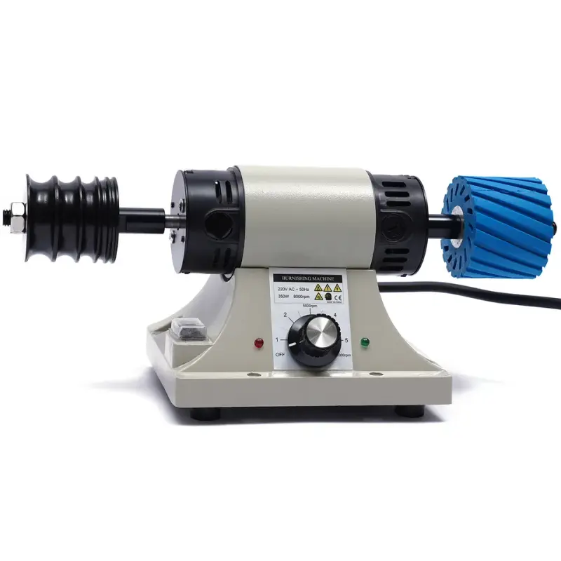

I'm starting to gradually upgrade my tools to hopefully improve my work and one of the things I'd really like to get better at is finishing edges.
I came across this inexpensive burnishing machine that can be had for $100 on Ebay and it looks nearly identical to the one Tandy offers for $200.
is there any reason to avoid this ?
The only real concern I have is the abrasives, I don't know how the sandpaper ( I don't think they're drums ) is attached or where I'd get more when I need it.
I have an older Tandy version and I wish I didn't. It is not well made and vibrates badly, making clean edges almost impossible. Over priced and under performs. IMHO.

Is it red ?
I looked this one up and found some good reviews on YouTube, reviews it sounded fine didn't seem to vibrate too much and good results were achieved.
maybe there's inconsistencies in QC or they have improved them over time or something, I'll look into it some more.
Not red. Have had it for about 3 to 4 years. The issue with vibration is due to the method used to attach the motor to the tools. It is just not possible to get them concentric to the motor shaft, at least on mine. Can't speak to new ones but they certainly look the same. I can't say it does not work at all but does not give me the results I was hoping to achieve. I think I should have saved my money and put it toward the Cobra machine. I have tried one and they are very nice.

With the shafts which have a machined flat for the set screws to lock them on ?

The shafts do have a flat. I don't believe the coupling glued into the burnisher is straight (with 2 different adaptors I have tried). I have the tools and means to remove them, rebore and remount which would probably solve much of the issue. However, I don't have the motivation. My answer was to get a really nice drill mounted arbor (https://www.proedgeburnishers.com/drill-burnishers.html) that works very well for my needs. They also make one that can be mounted to a motor shaft (https://www.proedgeburnishers.com/motor-burnishers.html). I believe they also make to arbors that are used on the Cobra machine. I use my belt grinder with dedicated leather belts for cleaning up edges.
