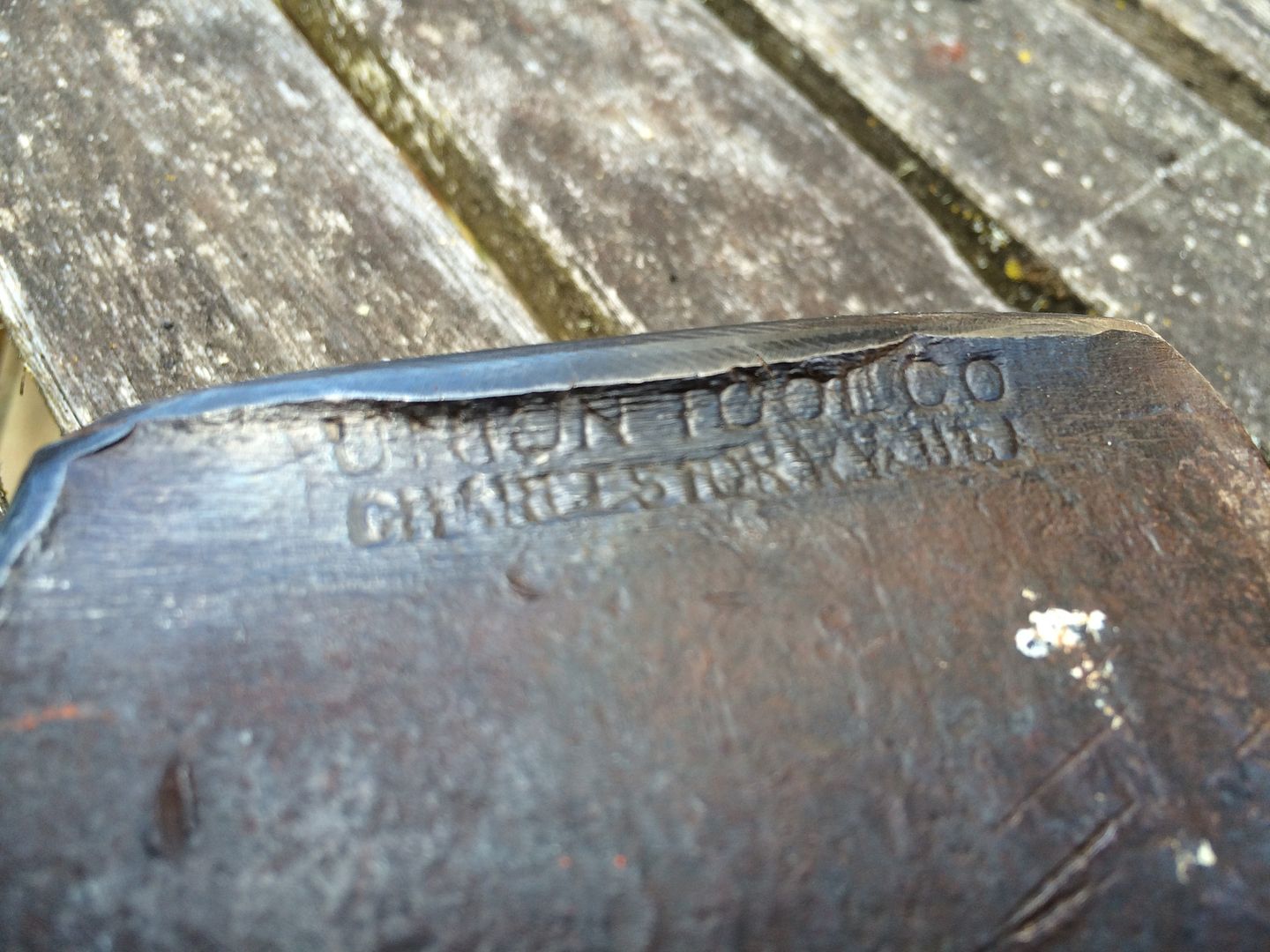

Don't usually blue them but I did this for a friend.
Here is an example of minor poll touch up:

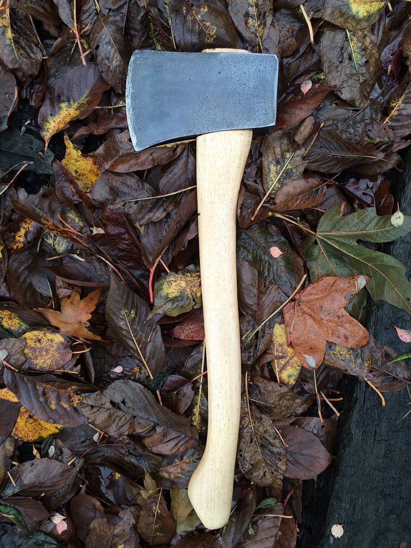

I blued a Plumb with cold blue.

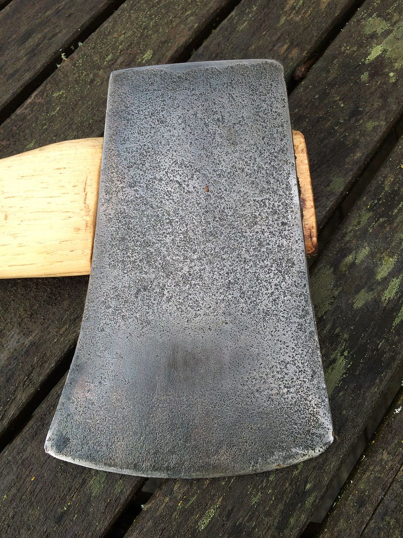

Have you considered forcing a patina with vinegar? I tend to do this with all my user axes as it seems to stave off rust in most ordinary use (as long as you don't leave it out over night or something).
Yes, the finish will wear away to a certain extent, however I find that with enough use, tree sap builds an additional patina over the top of the vinegar patina faster than it wears away.

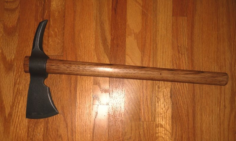

I rust blued the head of my CRKT spike hawk (Woods Kangee T-Hawk) and, although it was my first attempt at rust bluing and didn't turn out as nice as I wanted, I am pretty happy with it.
