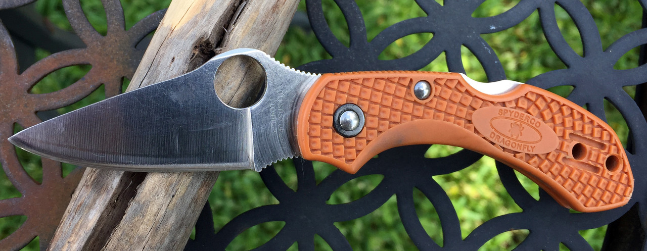

A quick update for anyone who cares (or wants a quick laugh) . . . (or wants a seriously over the top slicy little knife).
I did it. For good or bad.
First I put the HAP-40 blade in my black FRN Delica Wharncliffe handle. Turns out Delicas aren't that hard to rebuild see my post in the Nick Shabazz thread HERE AT THIS LINK > > >.
Then I blued the blade with dye, scribed a line 13mm from the edge all the way back to the bottom of the Spyder hole. Clamped a soaking wet sock to surround the edge of the blade to prevent heat getting to the edge. Took my Dremel with an abrasive cut off disc and in short bursts followed by drenching the blade in more water for cooling I slit the blade along the line and at the spine at the top of the Syder hole.
I rounded the spine on my cool running Norton X grinder wheel and cleaned off the dye.
OOOOOoooooh MAN . . . . what have I donnnnnne ?
This thing looks frail !
Whipping out the Mitutoyo Calipers I measured the thickness at the spine . . .
. . . wheeooh that's plenty . . . a FULL 1.3mm :D:p
In comparison my modded Ti Lite IV is 1.9mm at the spine and it is about twice as long.
Nooooooo problem (I hope ) (. . . to quote Hunter S. Thompson : Oh GodOhGodOhGodOhGod).:(
The freakin' wave/hook I left on there is way too grabby on my pocket. Even curling a finger around the tip of the blade or otherwise trying to take the knife out of my pocket without it hooking inside the pocket in my pleated baggy shorts was just too iffy. It might be OK with jeans. If I cut more off the hook I will be cutting into the jimpping so for now I have removed the pocket clip and will carry the knife in the bottom of my pocket or in a belt pouch.
Turns out that is pretty cool because it is super easy to just take the knife out of my pocket OR hook it on my pocket-opening to wave it. :thumbsup:
The knife is light enough that I won't notice it just loose in pocket.
(lighter now that HALF :eek: the blade is gone ! ! !) (Oh GodOhGodOhGodOhGod WHAT have I done . . .)
It'll be OK, It'll be OK, It'll be OK
:) More later.
PS: there is still enough blade above the handle when closed that I can pinch it open (I could put in a nail nick but won't) so even if I took the wave/Spyder hole off completely the knife would still be usable, but not one hand openable by pinching.
I cut some more off the hook; I took all of the metal off right into the jimping (before I had like 2.5 to 3mm before the jimping.
This makes it way less grabby on my pocket lining (I'm carrying it loose in pocket with the clip removed).
I think it is perfect now.
I can still easily thumb open it; still plenty of Spyder hole remaining for that.
I can easily wave it open on my pocket but it doesn't catch annoyingly like before.
Having the clip removed is interesting because much more of the FRN is exposed and usable.
This is useful when I flip the knife over edge up. I was cutting cardboard today to shape the pieces and it was best to cut it with the point pointing at the ceiling and the edge facing me. I know this can be dangerous; think holding the knife and pulling the cardboard past the blade with knife arm not traveling. It isn't as dangerous as it sounds. Short cuts less than two feet long. Works for me.
Glad I made the mod.
CAUTION : anyone taking this much off the blade needs to be careful not to break the blade. I think I should be fine for the use I will put the knife to. Light work.

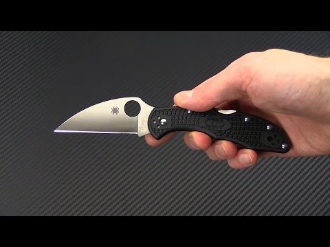

This thread desperately needs some pictures.
I'm not sure if I can actually visualise what you've done.
You couldn't be more right.
I can't post photos right now for a couple of reasons.
Here is a photo off the web that is pretty close.
Full flat grind it, take the wave (pocket hook) all the way back into the Spyder hole with the hook pointing up more rather than toward the blade point, and make the spine at the bottom of the Spyder hole and or a little above where the saber grind turns to the primary bevel in this photo and you got it.
All the blade where the Spyder is in this photo is gone except for the hook but like I said the hook is only way back nearer the pivot formed by the rear of the Spyder hole.
Oh and mine is a Wharncliffe so no blade belly.
PS : it started out looking like this Wharncliffe below

Pictures you want and pictures you will have :
That's a quarter next to the blade. The spine of the blade is rounded so it looks even thinner than it is.
Frightening isn't it ? !
I carried it with the clip on for a while. I thought I had gotten accustomed to holding it right when I didn't want the wave to hook on my pocket . . . until a few days ago when I was in a hurry, pulled the knife out of my pocket to put it in my back pocket (into the bottom of my pocket) and the blade opened partially and then closed on the back of my finger. No real damage done but it was drippy. All when I am in a rush to get out the door and on my bike to ride to work. All I can say is carry some wide bandage tape, stuff some kleenex in the hollow in the roll as I do (all clean in a zip lock) . . . AND FOR THE LOVE OF BOB DON'T PUT A CLIP ON THIS FRANKEN KNIFE IF YOU EMULATE MY MADNESS.
I removed the clip again. It works very well just carried loose in my pocket and I can decide as I draw it whether to hook the wave or not. The spring force of this lock back is quite strong so I don't see it opening on me in the bottom of my pocket. To be totally safe just carry it in a belt pouch which I have done the last two days partly because the wave jimping seems to have the potential to chew on my pocket and I just replaced my work pants where my Gerber Artifact had chewed up my pockets.
The knife is boring or disturbing to look at but I am so pleased with it's performance !
More compact now by quite a lot as well.
