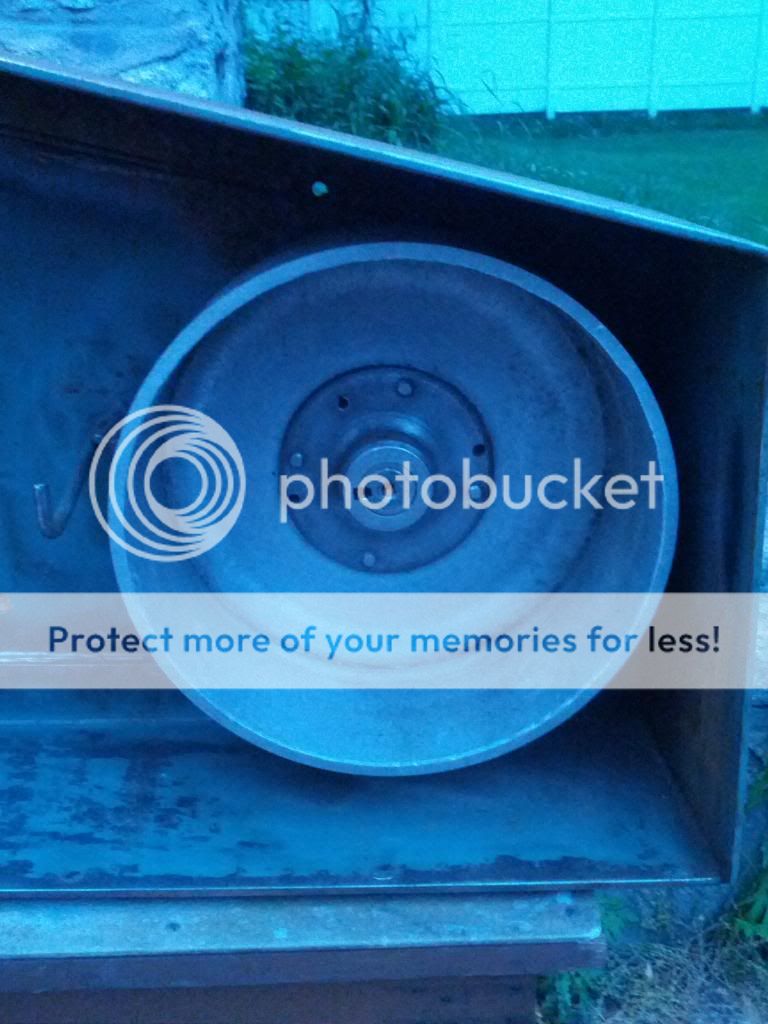

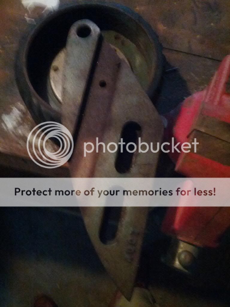

Is yours this old? It has a different system than the newer ones for changing wheels. pita to get off as well as the drive wheel.
