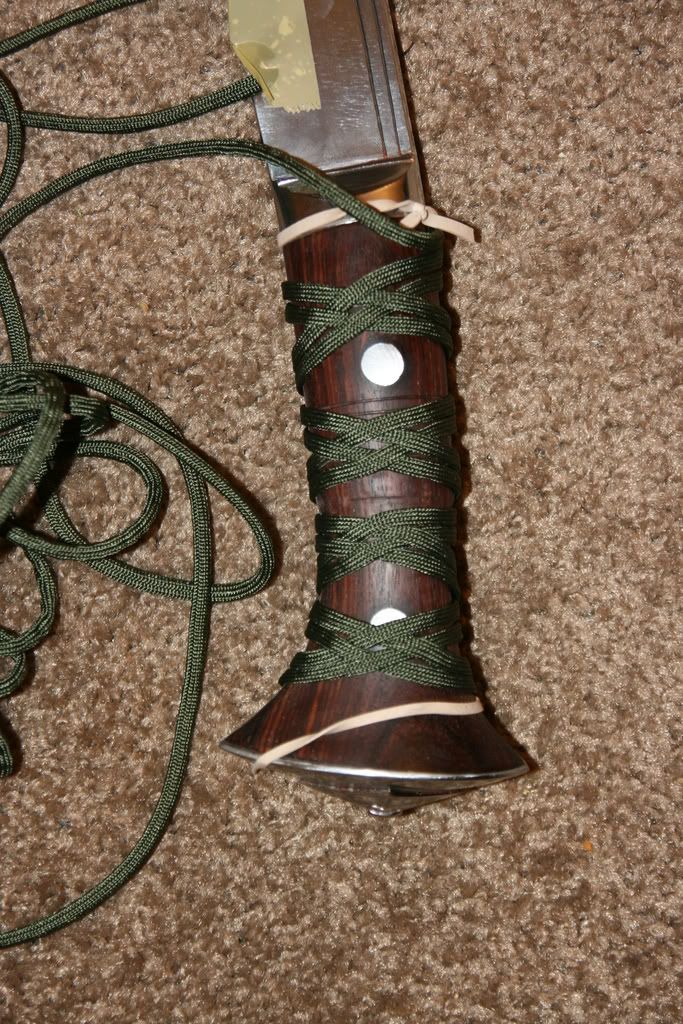

the beggining of the full wrap. I'm going to attempt 4 spirals for a full length wrap, but the first two attempts failed. I'm hopeing the rubber band guides will help the third attempt. the second would have worked just fine, but I'm tired of having every one of my full turks heads come out wrong on the top and bottom.

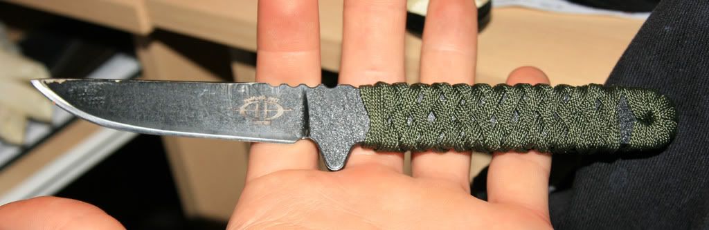

example:
my question was mostly how a really tight and hard cord wrap feels on a chopper, wether it digs into the hand to much. I love it on smaller knives, but have never had occassion to chop with one

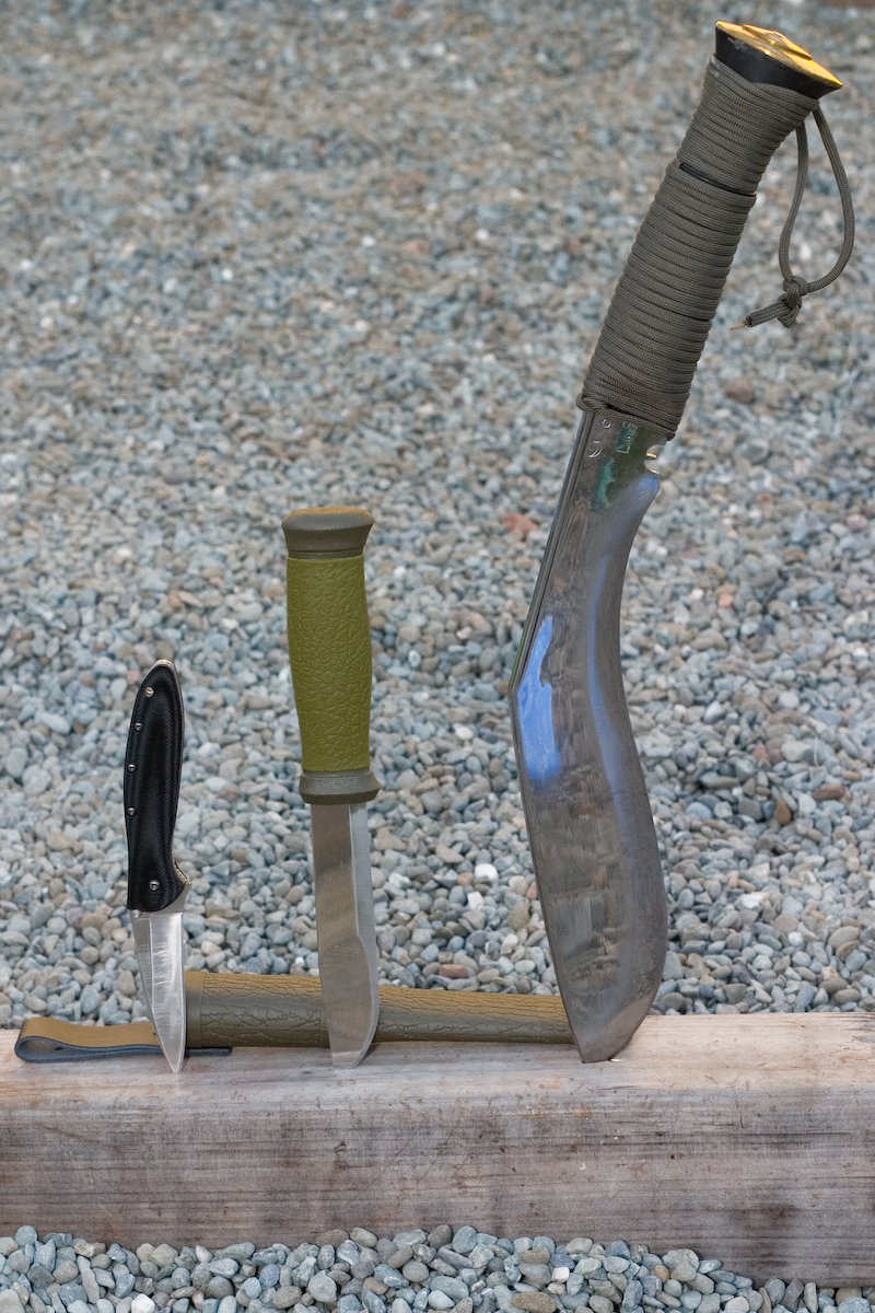

I did a very basic cord wrap on an 18" WWII. The wrap improved the handle ergonomics for me and I never had a problem with it loosening up. I've since wrapped the cordwrap with some self sealing silicone tape similar to the product here. www.ertape.com the grip on this knife is simply amazing now. The cushioning aspects of cord wrap with grippiness of silicone.
Here's a shot of it pre-silicone tape.
